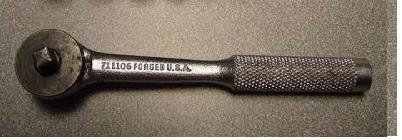

Today was a sad day. After replacing brakes and shocks on my '95 Rodeo I noticed that my trusty old EASCO flex head ratchet was starting to skip in the counterclockwise direction. I took it apart, cleaned and lubed it, but no amount of lube would remedy the situation. It's obvioulsy ready for a rebuild.
This ratchet is 25 years old and it's the best darn rachet design I've ever used. Silky smooth, has a nice feel, matt-finish, and made in USA
BTW-I just bought the Craftsman chrome offset flex head ratchet (see pic) and it's a POS compared to the feel of this old tool.
Does anyone know where to get a rebuild kit for EASCO ratchets, or better yet, whether they are still being warrented.
I'll get a pic and model number when I get back home this evening.

The Easco name is owned by the Danaher Tool group. I would contact them about getting a kit.
If the Easco ratchet has a double paw mechanism it may be nearly the same as this Craftsman:
http://www.sears.com/shc/s/p_10153_1...sName=Ratchets
These are very smooth ratchets. Most Sears stores do not carry them though.

I've checked all the Danaher sites and nothing comes close to that except a KD flex-head with a quick release; and I don't think you want a quick release.
Give me the EASCO part number and I'll email Danaher and ask them if there's a kit available for it.

From the looks of that ratchet head I would bet a SK kit would work.

The part number is 721412
It's silly I know, I have several other 3/8" drive ratchets (Craftsman, Snap-on, MATCO, MAC, and SK), but none of those compare to the smooth action of this old EASCO. I keep checking around hoping to find another, but they are scarce.

I fyou cannot find a rebuild kit for your ratchet, you may want to give these guys a call:
REB Enterprises
3155 Richfield Rd
Flint, MI 48506
(810) 736-1772
They are a small, family owned mom-and-pop type of tool store and they have a lot of new old stock stuff (Easco, KD, SK, etc....). I'd be willing to bet that Jason has one of those kits laying around.

I do not own either the EASCO or the double paw fine tooth Craftsman ratchet so I am not 100% certain, but I have used both and I do believe their product line overlapped. Do not confuse the double paw Craftsman fine tooth ratchet with the round head Craftsman ratchets that they stock in the stores. The double paw fine tooth ones are very smooth, strong, durable ratchets. Knowing Sears, they will discontinue them altogether soon. These should also be the same as the KD double paw round head ratchets with the quick release. Here are a couple of pictures of an Easco ratchet. Notice the selector on this Easco is the same as the Craftsman. I think the Easco one that a coworker had was like these but were like goodfellow's selector without a quick release. It has been a while since I have played with either ratchet so again I am not 100% certain. In any case, those Craftsman double paw round head fine tooth ratchets are (or at least were) nice ratchets. It is just so typical Sears for them to be rarer than hen's teeth.

The part number (721413) for the KD version of the double paw fine tooth ratchet is almost the same as goodfellow's Easco (721412). I believe the tooth #/arc swing info in the KD description is wrong though. If you look at the non-flex version it has the right info. They list a repair kit on the KD site. I don't know if the quick release is a problem though. It would depend on what parts it includes.
http://www.kd-tools.com/721413.htm
http://www.kd-tools.com/721109.htm

Is this the Easco model you are talking about? The top one is an older Master Mechanic that is identical to the Easco ones.
le6920 is offline   Reply With Quote

I have four or five of the Easco version and the Master Mechanic version pictured above. I've had them since they came out, sometime in the 70s-80s. I don't know exactly. They are the smoothest 3/8 drive I think. I use the heck out of them.
FYI, my ratchets have no play in them at all, i think the rebuild kit will solve your problem. I am happy to hear that there is still a rebuild kit out there as Easco was bought out in the 80s I think.

Just so I'm sure, is this the Easco ratchet that everyone raves about? Is it model 721109? And this is the same as a Craftsman 43781?
I'll get the Craftsman if I have to, but I'm going to look around for an Easco model first (just because I don't have anything by Easco)!
lbgradwell is offline   Reply With Quote
That be the one.
BUMP!
I need some more info here...
I want both an Easco 721109 and its Craftsman twin 43781. Has the Craftsman always been the 9-43781 or was there an earlier V-43781 (or any other prefix/number). I'm only interested in the oldest version.
Also, does anyone remember when this model was introduced?
I'm going to post "WANTED"'s for both these ratchets in the Classifieds too, but if any of you have one you want to sell, drop me a PM!

I'm sorry, but I lost track of all the different models. Which one is the 721109? Is it the 3/8" non-flex head version?
That is my understanding from earlier in this thread, Rolando. A 3/8" non-flex is what I'm after, at any rate!
Quote:
Originally Posted by MAD View Post
The older Craftsman round head fine tooth double paw ratchets that I have seen have had a -V- prefix code. I do not think the newer ones have a 9 on them. I think that is just a Sears department code that does not appear on the tool. I recently picked up some new ones. One is a VVW 42794 flex head and the other is a -KW-43781. I remember seeing these ratchets in the early 1980s. I would not have noticed them before then.
btw: The new ones that I got are nice but not as buttery smooth as the old ones I have used. They may just need to break in a little.
OK, good to know...
Then I want a buttery-smooth V-43781. And if it has "Pat." or better yet, "Pat. Pending", so much the better!

First, I have an Easco ratchet, part number 721107. It is a round head, non quick release, with the handle being sized and shaped like the new Craftsman thin pro line handles.
Secondly, I first found out about the Craftsman round head, by a friend who found a dead one (missing guts) on the side of the road. He didn't care what he got in its place, so I gave him one of the 1/4" pear head ones after finding it still in the catalog.
I took it to Sears, and the manager said to call corporate. They asked for the store number, the associate number, and the part number of the ratchet. Then he put it in the scrap bin, and they mailed me a new one.
The pear heads I have left, are very light duty stuff, or loaner ratchets. Heck, the import made Benchtop from Kmart, I bought when I was 17 is better. (I used to keep cheap tools in the car for emergency's. Now I would rather tow it.)

Here it is. I took my Easco - oops I mean KD - apart and it is the right rebuild kit. The kit is quick release, just like my Easco.
Cheap Danaher Tool Group does not include the lube.
Just kidding. It was nice of Danaher to send it without going through a headache.

64merc
Senior Member
Join Date: Jan 2008
Location: Texas
Posts: 2,478
Default Re: EASCO Ratchet
Quote:
Good, I knew it would work.
Hey, BTW, when I installed the same kit in my Easco flex head ratchet I encountered a strange problem. When I put older sockets on it, with shallow detents, the direction switch will not work properly. I have to take the socket off, switch directions, and then put the socket back on. This is because the ball bearing is still depressed slightly, thus not allowing it to change directions for some reason. This problem annoyed me so much that I found a similar style used ratchet and swapped in the used "kit".
I'm wondering if I got a dud, or if you'll have a similar issue. BTW, new Cman sockets didn't bother it as much since they have very deep detents.
64merc is offline   Reply With Quote

20 something years later I have another Easco. I have been looking for a 1/2" drive long handle ratchet at the flea market without any luck. Today I saw 2. The Easco and a Ridgid that looked like an Easco.
Bought the Easco 731116. 15" long. Looks almost like new. Here it is next to my 1/2" Craftsman.
