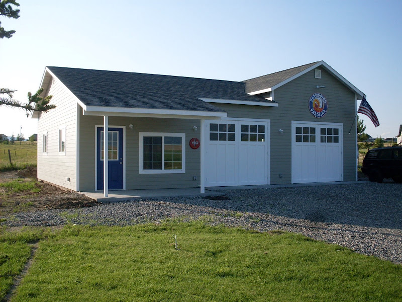

I'm building a 40x30 shop (thanks to all for feedback, this is the size I've decided on.)
My lift needs 12' ceilings, but at that size, 12' walls will look gargantuan, even on my 5 acres. I don't want the shop to look bigger than the house.
I can put the lift pretty much whereever I need to, and I'm considering 2 options, scissor trusses, or a raised ceiling (coffer). The 2nd option is quite an increase.
Can someone tell me if the scissors will work for me? I'm doing a 4/12 roof, 10' sidewalls. Or, so should I explore other options? I also thought about just doing a post and beam, and running the posts close to the lift posts so I don't lose floor space.
You can see the designs in the attachment. I added a 3rd garage door on the side which will allow easy access to the lift (mounted in center of trusses) and utilization for additional parking if needed.
Thanks!

Generally speaking the inside span of a scissor truss is one-half the exterior span. So, if your roof is 4/12 the inside chord will be 2/12. With a 30 foot depth the inside rise will be approximately 2" X 15' or 30" for total ceiling height of 12.5' at the center of your garage. If you put your lift's posts in the center of the span then yes, you could install your lift with 10' walls, but not as you have it sketched. You should put the lift in one of the two facing bays. If you keep that side overhead door, I'd put the lift in the left bay to keep the right side clear of the posts. You will also have to carefully watch the total height of the lift with a vehicle on it.
Interestingly, the total exterior height of your structure with 10' walls and 4/12 span will be about 15 feet overall (4" X 15' = 60" + 10'). If you increase your wall height to 12 feet, your overall height only increases to 17 feet. I'd be inclined to go the extra two feet.
Nice looking garage design by the way!

What I see wrong is the side garage door rails may interfere with something on the lift. Most likely you would need a roll up door on the side.

All said and done, the extra 2' might not be that bad. Before, I didn't have the little "porch" in my design, so the 40' wall just looked huge.
What I did here is simply leave that porch connector at the 10' height, and raise the roof to 12'. The main reason I was looking at the 3rd door was to accomodate the lift at the scissor truss height, so I just eliminated it completely.
I added a bit of signage over the main doors to also break up that space, which all seemed to work.
The area to the left of the doors (with the man door) will actually be a work space and parking area (dedicated to my forthcoming '65 Cobra FFR), so the intention is to use the left big door for entry (pull in, back up into that bay). That car, once done will be a summer-only car, so it'll sit for a majority of the year, hence not needing that 3rd door.
Eliminating the 3rd door and scissor trusses will probably save me $1500 (that'll pay for the gas pump ).
What do you guys think now?

I like it! As a matter of fact I like the separate porch roof better than the original sketch. You did an excellent job masking the height increase. Now let's get building!

Instead of the 4-1/2 roof, go with something higher....I did a 12/12 & have a whole upstairs with dormers...it'll mask the high walls - especially if you put a small 'porch' roof overhang across the entire front at a slightly different pitch from the main roof.
Here's mine with 12' walls:

auto: I do like your design, but the higher roof in my case would make it more obvious. The building will be 100' from the main house in an open area, and I want to keep it as low profile as possible. I don't want to over shadow the house, which is pretty big, but I want the shop to be secondary and kind of "blend in" from a presence standpoint (granted, once I make it look like a gas station, that might not happen). But, the muted gray siding is intentional to keep it less "HEY LOOK AT THAT SHOP!" ;->

autoist has the right idea...the steeper pitch will give you more height inside, and if you continue the porch roof across it will bring the height of the garage down a bit, what does the house looke like?

I don't think it is the steeper pich that hides the height of the wall so much as the fact that he has continued the slope out past the walls for the pourch roof.
That lowers the eve height, which is the visual line.
Do some playing with your software with an extended porch roof idea.

I like that split height look, it does look pretty nice. I'm not too keen on the additional materials and labor, however to accomplish it. There's a finite amount of "fun funds" for 2009 here, so I'm trying to get the shop in place as cheaply as possible so I can order my FFR kit.
I did run the 12:12 and 10:12 pitch through my software, and it looks a little like I put a top hat on a basketball player. Granted, no dormers, which would tone it down a bit, but I wouldn't spend the money on them anyway.
Just for reference since it was suggested. Seems too tall to me.

Hey, to each his own....you might want to try a small 4' porch overhang all along the front - pitch it a little less than the roff itself to make a break in the roof.
& you could still do your larger porch area at the door.

Take your first design and turn the trusses 90* over one bay. Run a steeper pitch 6 or so. Purdue's design but flipped. It will match the house better as well

I would put the lift in the center bay. By the time you get the posts up you loose alot of room to the wall. you may also consider angling the lift or moving the door a little further away from the other door to make sure it is easy to get in and out of the vehicle. And of course you could go an entirely different route and go with an in-ground lift.
