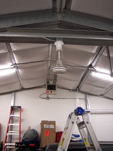

Thought I'd post the install per my findings above:
Above: The G73 was mounted up high at the roof peak -which is approx. 12' 2" high. The Dayton G73 heater is mounted straight to the roof peak beams (drilled two holes in factory bracket) and the heater is spaced about 2 feet from the end-wall. Hot air travels 11 feet over to center-mounted Agrifan with downward curved blades (downdraft fan). The fan's overall 60" span with triple blades are spinning so fast in this image that you can barely see a blurr near the hub.
We mounted a Dayton remote line voltage Thermostat at shoulder level and a small GE disconnect box to provide positive off for the heater. Dig the fancy skip-troweled dry wall finish. The entire 1200 sq foot garage is like this. Long story.
Above: View looking up at G73 heater from thermostat mount. It sure works nicely installed this way. I can stand all the way accross the shop 26 feet from this wall and feel nice warm air at shoulder level. The fan is the key I am sure. It distributes the heat and does not allow hot air to stack-up in the ceiling. After the fan runs a bit builds-up a circulation pattern which evenly distributes air to the whole room.
Hopefully I'll get away with having only this one G73 in this 780 Sq. Ft. garage space (26X30). If not, then I have another 30 Amp circuit on a different wall to use; in case another G73 is called for. Won't know til next dec./Jan.-as that is when it can dip to below zero here in the high desert. It was 30 deg. F outside and I got the garage to 58 degrees on the opposite wall in a short time-maybe 30 minutes-measured by a digi-thermometer. Both the fan and heater make some sound-but not objectionable at all. Nothing a radio wouldn't drown out.
I'll be putting another Agrifan in the adjoining and seperated 13 X 30 workshop portion of the building too. This other room will be getting a baseboard heater and an infrared heater.
So just another way to not climb a ladder to control the G73. The thermostat in the G73 was bypassed all together. My electrician did the wiring.
