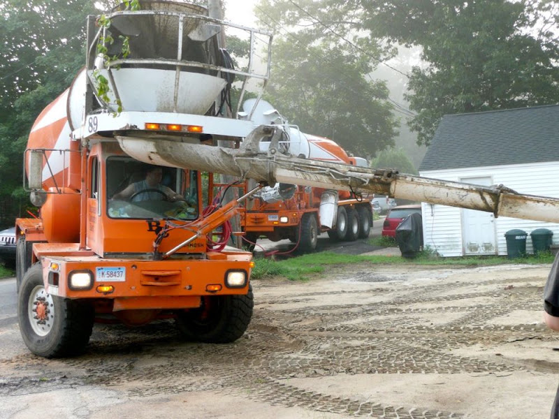

had cement trucks at the house at 6:15 this morning pouring the slab.. will post pics later

Ok here's the pics from this morning when the slab was poured
6:15 am:
don't mind the conduit half sticking in the cement :laugh: that was a goof on our part when we drilled the holes in the cement.. we measured wrong, so it was slightly low. doesnt really matter since there will be 2x8 framing on the floor there to give us room for the conduit and plumbing into the old part of the house
Its 6-7" 3500psi with fibermesh and chickenwire on top of 6 mil plastic. Its pitched about 1 1/4" to the front
