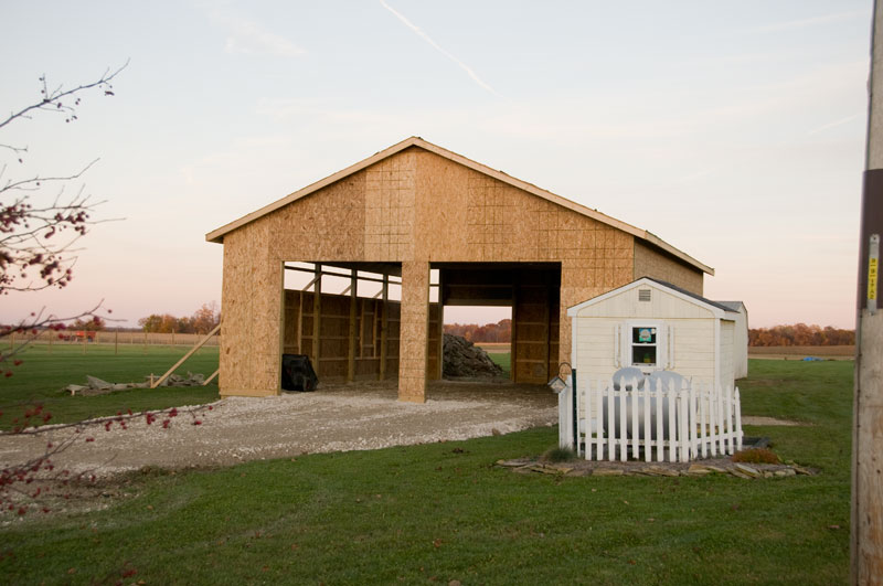

Today was the first nice day we have had in a while... 50's and sunny. Here's some closer pics of the building.
You can see that the 8' door on the back was moved 4' away from the center. This was in an earlier set of plans to get some more space for a pool table in the 'man area'

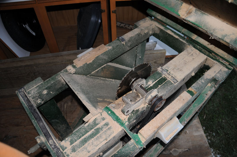

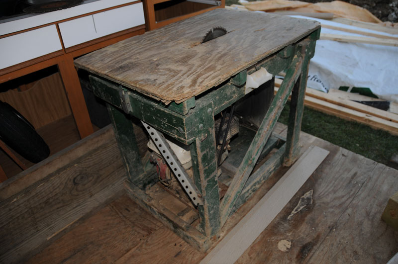

their table saw
The only thing I found that I didn't like. The cut on the outer osb was a little wavy and leaves a gap 1" at the widest part.
I went with a 5/12 truss for some usable attic storage.

Coming along nicely! Can you get a few more pics of their table saw?

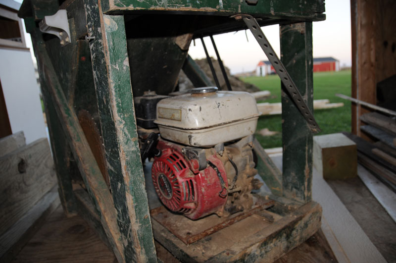

Here's some more pics of the amish table saw:

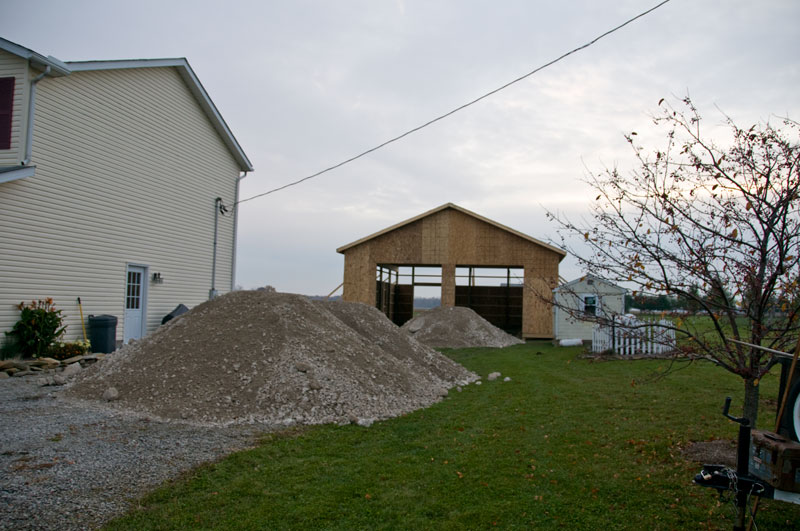

I got home from work one night last week to see 3 HUGE piles of concrete/gravel mix
The next day it was all leveled out, they had a guy come in w/ a bob cat to do it.
He also took all the extra dirt from the post holes out of the barn and piled it out back.
I took some pics yesterday:
There was enough extra to extend the gravel driveway to the barn which really made me happy. I figured I would be mudding through the grass until next year when we could have the driveway done.

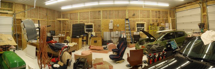

Here's how I plan on fitting everything inside
edit: the attachment script really shrunk the pic down... I'll host and post it again

Here's how I plan on laying out the inside. I thought about diving the back half to keep the dirty area and the man area separate, but that would really limit the use of the garage in other ways. The building faces west and we have a breeze pretty much every day where we live. (only ran the air twice this year!)
So the plan is to open up the back 8' door and have a nice wind through the shop to carry through dirt, sawdust etc through and out of the back corner. On nice days, I'll roll the table saw, welder etc to the slab outside the 8x8 door and do all my dirty work outside.
I'm keeping the space as wide open as possible because I may be using it as a photography studio shooting vehicles, but not for another year or so. That's why I went with the 12' ceilings.
People say build it as big as you need, then add a little more.
32x40 is big enough for now and the near future. After seeing how big this building is, I can't imagine having gone with a 32x48'. That extra 8' would have been really nice but this size is already looking like a monster behind our house! I'm just going to have to learn how to use my available space better and actually try not to collect as much car parts (or as my wife says, junk) but that's what the attic is for!

updates!
insulation down
Pex tubing layed over the insulation
Concrete truck came on Dec 15th
Then I had to wait 10 days for it to cure. I was out of town so I waited 15 days.
Then they got the shingles on.
And it snowed....
Then siding, cold weather doesn't slow them down a bit.
Door seals...
And it's all done! It passed inspection a few days later.
Our driveway is a mess! The yard has a lot of sitting water around the building & driveway. That's gonna have to wait till spring.
All moved in! Well, for now... I'm keeping as much as I can at my parent's place & in my basement until I get everything done on the interior.
I'm going with OSB on the walls. White sheet metal on the ceiling, and galvanized sheet metal for the bottom 4' of the walls (kind of like Chipotle has)
I'm going to order everything this week because prices go up in a couple of weeks. Then I'll be doing the electric & plumbing in the meantime.
I'm not going to bother with the heating for now... It's going to be warming up in a couple months, so I'll have 6 months to look around for a deal on a water heater.

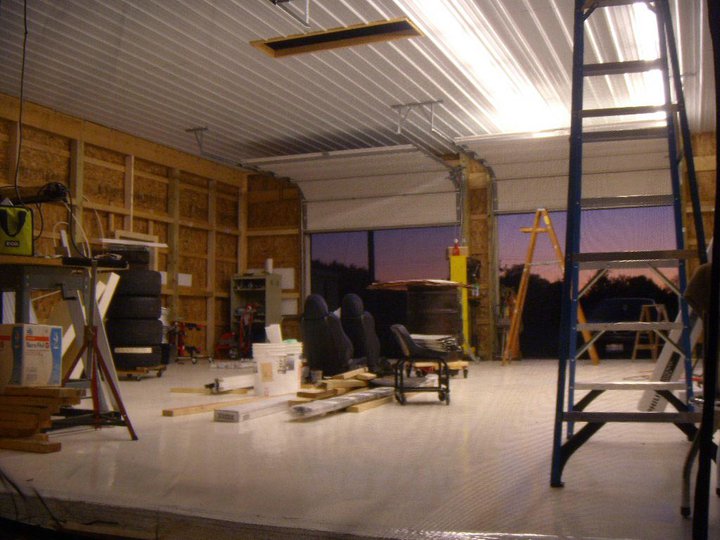

ceiling is done, next came the floor
I had found a deal on some used t8 lights on craigslist. They were all pulled from an old 84 Lumber warehouse, but had been upgraded to newer ballasts.
This was in October, so everything wasn't moved in for winter storage yet.
I decided to do OSB vs drywall, so I needed to put up some bracing between each 6x6 post for the OSB to attach to.
I ran a 2x6 vertical, between each of the posts, so that the 2" side was facing out for the OSB to attach to. So the posts were 8' apart, with a 2x6 in between, so every 4' I had a column to attach the OSB.
Then I ran 2x4's horizontally, between the posts and the 2x6. I ran one along the bottom, one about 4' up from there, and then another one about 4' from the ceiling. The 2x4's had the 4" side facing the osb, since the middle 4x8 sheet was going to share a 2x4 with the top and bottom sheet. This gave me all the surface I needed to attach the 4x8 osb.
The vertical 2x6's were in the center of each 4x8 sheet (I hung them horizontally.) and the 2x4's were there to support the top and bottom edges.
I got around to finishing the radiant heat setup before it got too cold. It's amazing how efficient this heat is!
Then I got the insulation up asap since it was getting cold...
and everything came in for winter lol.
Moving everything around as I worked on the walls... Insulation & vapor barrier, then 7/16" OSB
I just finished doing the blown in for the attic and now I can be out there working for a few hours and not even have the heat kick on once!

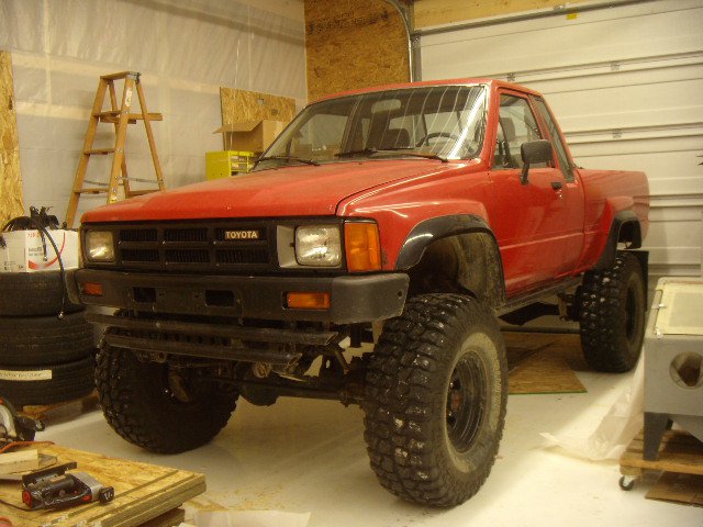

I also sold one of my civics and bought a new toy...
I've been looking for a decent Toyota pickup for a year and a half and so many up here are rusted through. I found this '85 on ebay, turns out the owner only lived 2 miles from my house! It was meant to be
It's been pretty useful so far (that's the Atticat insulation blower for the attic)
but my wife hates it
In the first truck pic, you can see I have the vapor barrier up and I'm currently in the process of putting up 7/16" OSB sheets. Then I need to build some cabinets and it will be complete!

Default Re: 32x40 Pole Barn - shop / man cave
You guys remember my 85 Toyota?
https://youtu.be/IlCmOYdwZII
It got fresh paint for its 30th b-day:
