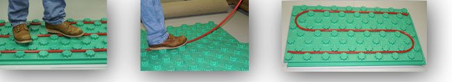

Default Crete Heat
The topic of insulating under the slab for radiant heating has been batted around this forum and this is just one more version. Has anyone used Crete Heat insulation panels? This is the 1 or 2 inch thick 25 psi polystyrene panels with plastic disks on top to ease the installation of the pex tubing between the disks. Any pricing info?? Foamular 250 at 2 inches thick is about $1.00 per sq ft, so how does Crete Heat compare? For someone who is not putting a dollar figure on his labor and planning to zip-tie pex to wire, is it worth it?

Crete-Heat the 2 inch will give you a more constant R value than other insulation which tends to "outgas". It has shiplapped joints providingfor a continuous thermal insulation, 10 mil polystyrene film vapor and radon barrier, has the 3" on center fasteners that allow for quick tubing installation . It is a simple install product that holds the tubing, insulates and provides vapor barrier all in one product. The install time is cut up to 2/3's!! When you are doing radiant, who wants second best? See a video at www.crete-heatinsulatedfloorpanelsystem.com

"Crete-Heat the 2 inch will give you a more constant R value than other insulation which tends to outgas". I'd like to see some independent research on that. Frankly, I don't think the off-gassing in XPS amounts to much. Polyurethane foam off-gases, though. Looking at the specs on CreteHeat, the R-value is the same as XPS (minus the alleged off-gassing reduction, which I've not read about being much.) The perm rating is .51, whereas I think 2" of XPS is about 1 (more permeable), but 6 mil visqueen has a perm rating of 0.06. There are better, tougher vapor barriers/retarders, too, (Tu-Tuff, for one) that ought to go down regardless of what "insulation" product you use; all foam sheets have edges that leak, esp because you can not install them perfectly lined up, esp after the job is completed; too much traffic. I'd be careful w/ the psi rating, too; my engineer called for 40 psi XPS under my slab, FWIW. CHeat looks fast, but spendy, and I am not convinced you are getting a great deal out of it. That's my 2 cents. john

Since I started this thread I learned that the high cost of crete, about 3-4 times the cost of regular Foamular 250, is not a value for the regular homeowner. I guess the only savings is in labor for large projects like a 10,000 sq ft aviation hangar. I can bend over and zip tie 1000 feet of pex and use the $1,800 in savings for the tankless heater and manifolds (and have $$ leftover for ribs and beer for the concrete crew).
