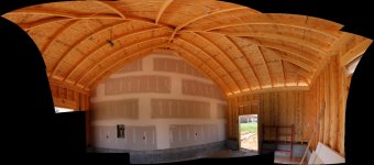

Here's mine - it's a single bay, 16x25. It has a hip roof and the ceiling is vaulted. This is a composite of seveal pics, so you have to overlook the distortion, but hopefully you'll get an idea of the inside.

That's exactly what I want mine to look like, thanks! The size is almost the same as my plan too....I'm planning 16x24. What is the pitch of your roof?
I'm guessing your roof was all stick built? What about the sill plates? They look much beefier stacked 2x4's. Engineered beams?

Yup, it's stick built and is attached to the house. Sill plates are stacked 2x4's in that garage.
