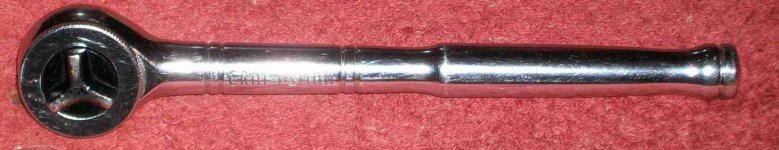

Thanks Gary,
That 1/2-inch boxhead date I gave was merely a guess based upon a 1954 Sears catalog. I purchased it at an estate sale recently along with the VV ratchet. Both had light surface rust but cleaned up rather well. Thanks again for your trouble.
I thought I would go ahead and add another photo with info to give your new listing some dating. The 3/8" KOZ ratchet below is 8-inches long compared to the shorter VM ratchet shown previously. I purchased this KOZ ratchet in a 255-pc mechanics set last November, 2010.
Model # is 44808 for the KOZ while the VM is model # 44811. The VM date sounds about right. I probably purchased that from Sears around the mid to late 1990s.
Other ratchets in the mechanics set include a T4Z (1/4") and a K6Z (1/2").

kc-steve,
Thanks for the new ratchet info. Just to clarify-- is the series code KOZ or K0Z (zero)? Looks like K0Z (zero) to me and that would fit the usual Danaher series code conventions.

Yeah that's my mistake, K(zero)Z.

Crafty Fans,
I've added one new code (KAA) and updated another code (C) with new information:
KAA = Danaher, ca. 2011 - ? (yet another new Danaher ratchet code)
C = likely Crescent division of Cooper Industries, ca. 1964 - 1973, possibly later
If anybody has any Craftsman Tool catalogs dating from 1975 - 1989, please let me know. Any help appreciated...
