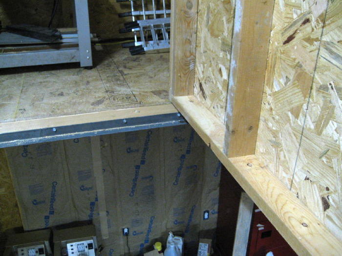

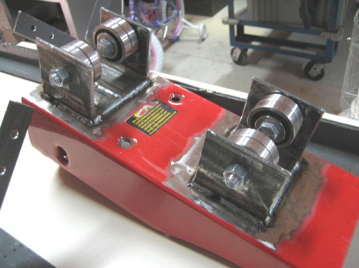

We bought a cheap HF hoist ($75) rated for 880Lb (880lbs with the cable doubled up and 440lbs with the cable straight). We plan to ONLY use it straight cabled and will most likely lift nothing more than 200lbs with it.
The idea was to store large objects that you don't use all the time to MAX your floor space. (ie: 200lb table saw, 20Ton shop press, fenders, hoods, bumpers.... )
Anyway, here are some pictures.

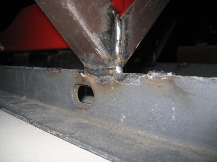

First we modified the Hoist Case to add bearings for wheels.

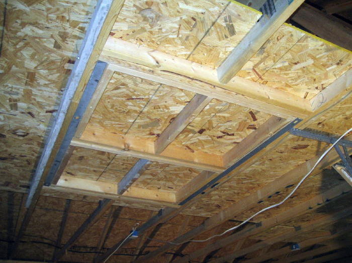

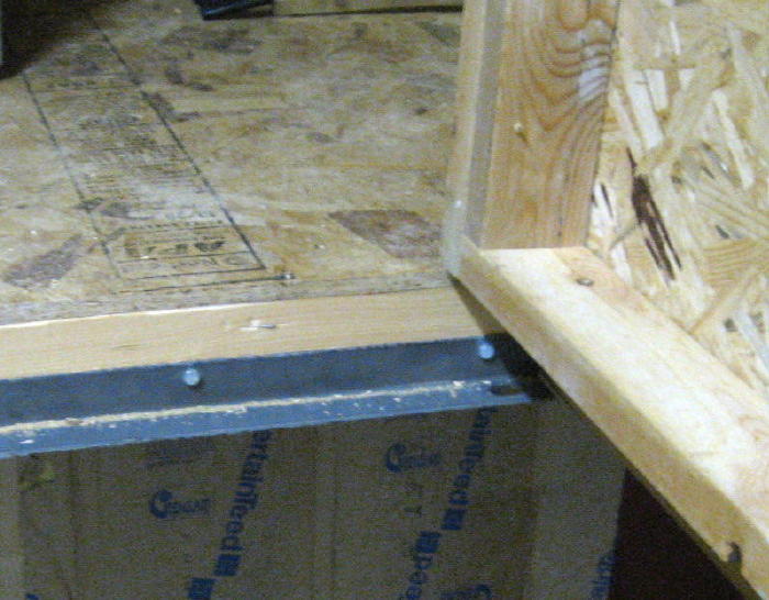

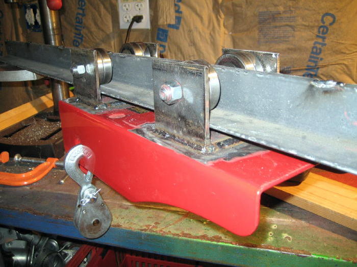

Using 2 pieces of angle iron, we made a simple track (2 sections 7 foot long ea, total of 14 foot of track)

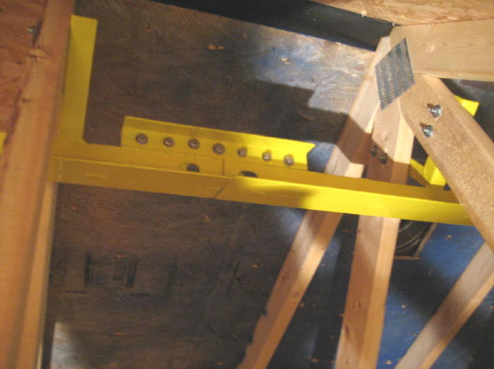

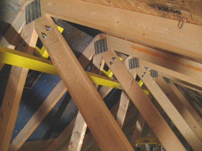

Then added mounting points to connect to the joist
After a yellow paint and installed

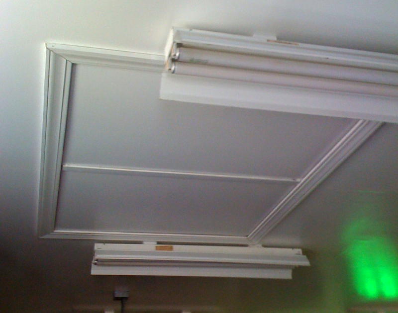

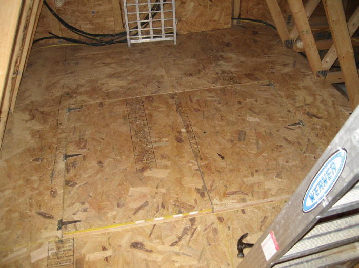

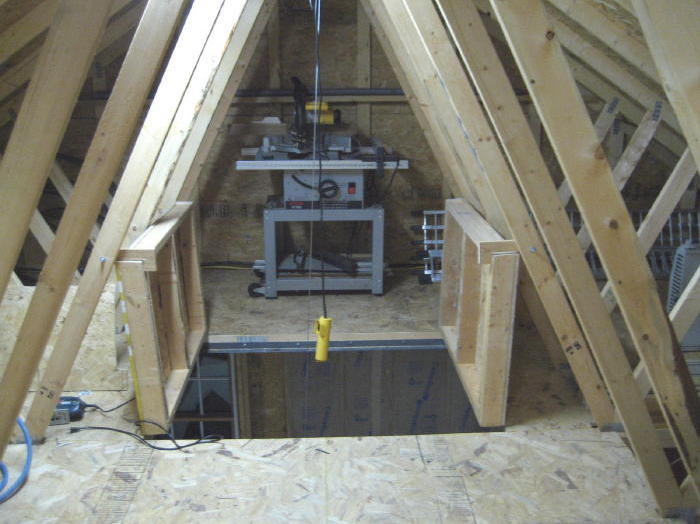

The attic floor now has a 4 x 5 foot hole when opened and can be walked on when closed.
The system works great, I hope you enjoyed the pictures.

Excellent job, What I would have done different...nothing! Welds look great. , safety yellow nice touch. As the A team say "Love it when a plan comes together"

The hinges do not hold any weight other than the doors. The doors can be walked on when closed because they are supported with 2 pieces of 2in angle iron.
When the doors are opened, that are latched with a simple hook made of wood.

What's the trick to lifting something oddly shaped like a table saw? I assume you don't just attach the cable around a leg and pull it up, right?

I just used tied down straps to level it out, then connect up the hoist cable. This allows me to get the cable snugged up before lifting too.
