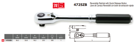

this is the newest zeal section of the catalog (dated april 2023). notice all the quick release variants.
i wish they had a badge that showed you if it's a 3/8" in a 1/4" body so you could tell that a glance.
they should have that next to the other badges. the only way i see to tell is to look at H (9.5mm vs 13.7mm).
The 1/4" body part numbers always start 272. The 3/8 drives in 1/4" bodies always end in -3/8. For example, a non-flex head will have a part number 2725Z-3/8.
I received a 1/4" drive 2725Z in a P2285Z set from Japan last week. It is really nice. Much smoother with less back drag than my 1/4" LP90.
Thank you for sharing the pdf!
The quick-release button shape is a little different between those two body sizes; 1/4" body with 3/8" square to the left, regular 3/8" to the right.
So many 3/8" in 1/4" ratchets but no still no 1/2" in 3/8" ratchet :(
Although the full size 1/2" quick release does look pretty nice!1677797648400.png
