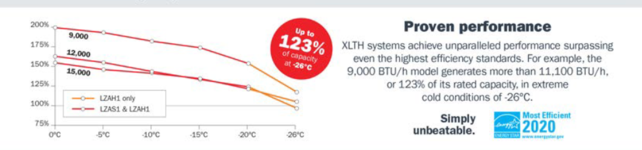

I'm in western Wisconsin, east of St Paul/Minneapolis, and we had 2 Fujitsu XLTH (Extra low temperature heating) 15k minisplits in our old farmhouse, and they did well heating that space most of the time. They were both downstairs so we had some resistant heat in the upstairs bathroom that was used only when my wife was bathing. When it got really cold, January and February, we used the wood burning furnace to provide more heat, but that was more because of how our utility credited us for our solar electric production. Our minisplits did fine in low temps and we used them exclusively, no wood backup, a couple of winters ago. Mitsubishi and Fujitsu both make minisplits that do well to minus 15 degrees or so.

Check out the low temp minisplits, full rated heat down to -26 F. Propane is expensive compared to an efficient minisplit. My electric runs $.11/kw, so for me propane is just under 4 times as expensive
Below is a spreadsheet link, download, then open. You need to replace present day fuel costs variable in the spreadsheets cells. If you go with a very efficient unit use 400% in the "air source heat pump " "approx efficiency (%)" cell otherwise use 300%
Heating Fuel Comparison Calculator
This is the strangest performance curve I've seen published. Seems like someone in marketing managed to play with some numbers:
This thing is rates to 123% at -26C. I mean that's great. But that's also a substantial reduction in it's heating capacity compared to how it does at zero. It's like the intentionally "underrate" the heating capacity so they can claim it's super efficient at -26C.
Yes the units produce far more than than the advertise rating, no issue for me, especially since a 12K unit cools my 30X36' garage and temporarily my 1350 SQFT attached home until I finish installing (3) 9K minisplits for my attached home.
"It's like the intentionally "underrate" the heating capacity so they can claim it's super efficient at -26C."
They are NOT stating the units are super efficient at -26, just that it can produce at least full rated output at -26. So is there something wrong when the units put out the full rating or more at -26, and far more than the rating at all other temperatures with a much higher than average SEER and HSPF.
That is why I purchased all extra low temp, high efficiency Fujitsu splits
