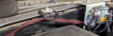

Nice. I recently decided to up my wiring game in my Jeep. Did a hard-mounted on-board air compressor.
When you come back to clean up your wiring get some of this tape, works great. Much better than electric tape which tends to unravel over time. https://www.amazon.com/gp/product/B0821HFZGQ/?tag=atomicindus08-20
Also I highly recommend this wire loom. It is not split like the corrugated **** that is impossible to put longer wires into without the special tool: https://www.amazon.com/gp/product/B074GMN7BK/?tag=atomicindus08-20
Both of those together really clean up the wiring job. And the loom does a great job at protecting the wires.
I have built a fair number of fairly complex wire harnesses and looms. I almost always do it with spiral wrap to wires can come in and out at various places. If protecting wire from UV, road dirt, etc. is needed, after harness is done stretch it out and wrap with vinyl tape and if REALLY serious about covering it all (and spending a lot more) wrap it in self adhering rubber tapes (that I have used for years to seal up high volage terminations).
Pics?

Sorry, nothing handy. Most are running around under various trucks I have upfitted. I keep a large tote in my storage area with a full range of spiral wrap sizes on reals. I used to do aircraft harnesses by tying off with cord. Not sure plastic wrap would be allowed today, but it would have made the job 100x easier back in the day.

This type of tie down cleans up the mounting issues.

Do you have a link for those? I wouldn't even know how to phrase a search. But I like them! Thanks!
@cosmokenney, Google (or Amazon) search for "mount cable zip tie."
Or these, for when you don't have or want to make a big hole:
Or these, when you have just a small screw hole:
I also have a bunch of these in my zip tie shoebox:
