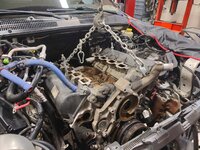

My son and I made some good progress last night on the WJ, then my DIL brought my grandson over to visit while we worked, and the Jeep became second priority for the night. He kept pointing to things in the engine bay saying "oooh" and "what's that sound" when I'd zip a bolt out with the cordless ratchet. He's such a curious and inquisitive little guy for only being 14 months old. I hope to be able to spend many, many days in the shop with him as the years go on.
Picking up where we left on the night before, now all of the wiring is disconnected and laid to either side of the engine bay. Coils are all removed as well as the fuel rails and injectors.
Next the intake manifold is removed and access to the engine dipstick was then exposed so that was removed. That stinkin' thing was stuck in the block pretty good. Removing it while trying not to damage or bend it was a chore in itself.
Then the A/C condenser was separated from the radiator and the radiator removed exposing the front of the engine and this should give us enough room to pull the engine.
Last item for the night was removing the water pump and installing a lifting chain after removing the final two bell housing bolts just behind the intake manifold as they were much easier to access from the top with the intake out of the way.

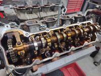

With the 4.7 liter disconnected it was time to ****** it out of the engine bay.
Unfortunately, the motor mounts were the hang up. Once they were removed the engine easily came free from the transmission bell housing.
Pulled forward to the core support and it looks like it will easily clear the firewall as well as both sides.
Almost out. We did have to remove the front tires/wheels in order to set the nose down low enough for the oil pan to clear the core support.
And it's out.
Bolted to the engine stand for disassembly.
We were pleased to see how good the inside looked as we opened it up.
The cams showed very little wear and the inside had that nice gold tinge from the oil.
Only a very small amount of sludge or carbon buildup was present, and this was near where the PCV pickup joined the oil spout.
Timing chains and components showed very little wear as well. The guides barely had a few wear marks visible and nothing was damaged or pieces missing.
Even the coolant passages were relatively clean.
Stay tuned for more pictures.
