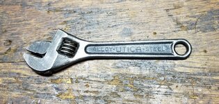

This Utica, found at the flea market yesterday, is the first and only Utica in my 4-incher stash.
I am not familiar with the markings and could not find this style branding in any catalog, but I have the feeling it may not be very old, and perhaps not even vintage. From 1950 to 1968, the catalogs are very consistent about the 91- series being plated and the 90- series being black finish. This 91-4 is clearly black.

I have not intentionally collected chrome-plated Utica adjustables. I do have a 91 and a 93 that are.
I have four 91s in plain steel - 6”, 8”, 10”, 12” - and was likewise surprised to see them. (The 6” may have a cad wash on it). The illustrations of the 91 are lighter than the 90 (when included), but I’m not seeing the 91 described explicitly in print as exclusively chrome plated in the pdfs between 1939 and 1967 (in which they are so described).
The characteristics that might help date the wrench include the reinforced hole, lack of a raised panel, and the content and design of the logo:
There is no 3-diamonds mark and there is no Triangle mark. There are periods after each letter of “U.S.A.” The “U” is flat-bottomed and the “A” is barn-roof with the cross-line extending forward from the left down-stroke in “UTICA” on both faces of the handle.
My 6” has the barn-roof font only on the left face, while the 8” has it on neither face. My 10” and 12” examples look the most like your 4”.
The catalog illustrations I’ve seen of the 91 don’t show any variation between 1939 and 1967, so possibly advertisements could help narrow the dates. Without more than condition to go by, I do think they are vintage, maybe 1950s, but who knows?

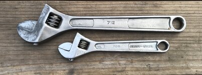

A good friend of mine handed me a box of wrenches
He said, you like old tools!
So, here you go
It's not much, and certainly nothing to look at, but one of my few Utica tools
So this is my rather small and meager contribution to this thread
I have never held a Utica wrench they are a rare item abroad as are most things Utica ,thank you for sharing.

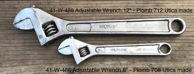

So, here you go
I like that Utica adjustable wrench as it clearly demonstrates that Utica was supplying adjustable wrenches to Plomb before the Danielson acquisition. IMG_1243.jpegIMG_1242.jpeg

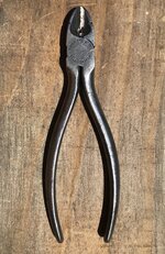

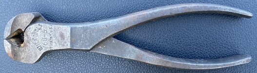

IMG_1653.jpegFound four old pairs of pliers today. None have model numbers. All have U-TI-CA logo forged inside handles. Three are probably No50-6, one of which has the 3chainlinks logo, but has been reground into something else. I might have left it behind, but the addition of the “DUKE” stamp made it irresistable. IMG_1654.jpegThe small pliers are probably model 20-5.
