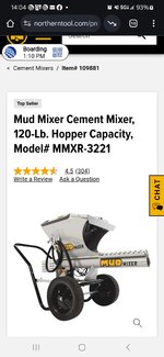

Watching Mud Mixer vids it seems like there's a fair amount of waste initially getting the mix right and there seems to be occasional jams of aggregate in the screw mixer tube.
I watched one youtube video on the mixer and set the water setting to what they guy suggested and had no waste and didn’t even think there would be jams but I suppose with rocks it could jam, never did for the 39 bags I did though.
And, for the half a dozen times I have mixed concrete mix for myself I would just rent.

I've seen MudMixer mentioned here a few times. Last year I spent the $3k buying one and I can tell you it does everything that they advertise with ease. My 130lb wife loaded an entire pallet of 60lb bags by herself when we did our gate project. I have about 5 pallets of concrete through it so far.
Most rental places(not big box stores) around me rent the mudmixer for about $100/day. You should definitely look into that since you dont have a big project. Something to keep in mind is that sometimes 60lb bags are cheaper by weight compared to 80lb bags.
mike93lx
Dec 9, 2013
37,495
Richmond, VA
How much are you mixing to justify one? They look neat but at over $3k, it feels like a stretch.
It also doesn't look like a machine that justifies that price tag. I wonder if there is something I am missing or if they charge that just because they can
