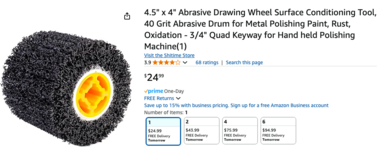

I stopped in to HF this morning to see about the Bauer SCT....
I got the last one on the shelf...
Was thinking this would come in handy with stripping the paint off the garage door I'll be working on this Spring...
Need to see if I can find one of those woven wheel jobbies that won't get clogged with paint... None at HF...
Saw this one on the Jungle site, but sorry, I just can't buy it from this merchant store... :ROFLMAO:

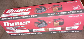

Welp, Garage Journal strikes my wallet yet again. lol
I wasn't really intending toget one but I was at HF getting something else I did need and there they were in a display stacked up on clearance. Currently have no particular use in mind but seemed like a good deal if I ever do.
