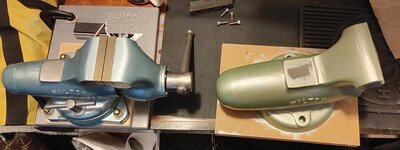

I'm restoring the 8400 HD I bought. This time I had Home Depot mix up some PPG Mucho Mint, (MTL122). These colors may not be exact matches to the original colors, but they're the closest I've been able to find, without paying somebody $150 for a can of spray paint. I had to brush this on today because I once again couldn't get the PreVal sprayer to feed the paint, even though I had thinned it down to 4 parts paint to 1 part water. I put four coats on, on top of the Rustoleum self etching primer I applied yesterday. Tomorrow I'll reassemble the vise. This one's going to replace the 350S I restored, to be my everyday vise, unless I go bigger at some point.
These colors are both metallic, and really pop under direct light.

Thanks, I may take you up on that, for the next one if you still have them.
But in the meantime I used this idea that I came up with, mostly because even with the proper inner ring the side to side movement, when loosened enough to swivel the vise just bothers me. I'm by no means OCD, but it does. I sunk a 1/2" by 8" lag bolt into my workbench, then took it out and cut the head off and chamfered the stub. Then screwed it back in.
the stub fits into the center hole on the bottom of the vise's body and keeps it from sliding side to side when I loosen the handles to swivel it.
Even the 350S sitting next to it, with it's proper inner ring moves side to side more when I'm swiveling it than this one now does.
The part number of the base on the 400 is the same for 400, 450, 500, and 1750's. This base was originally for a 1750 according to the seller I bought it from, and it only came with the mounting pads (cleats), but no inner ring. Even though I essentially bubba'd it, since it's just for me and it works I'm happy with the setup so far.
What do you guys think of that green paint? Pretty close match to the original? Or not?
edit: in perusing some of the old catalogs I happened upon a note in an excerpt from the 1942 catalog included below which essentially indicates the HD vises were built to milspec.
