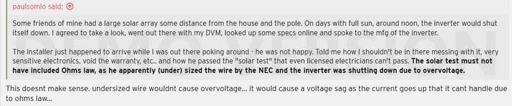

paulsomlo
Jul 16, 2013
3,915
Northern Colorado
Some friends of mine had a large solar array some distance from the house and the pole. On days with full sun, around noon, the inverter would shut itself down. I agreed to take a look, went out there with my DVM, looked up some specs online and spoke to the mfg of the inverter.
The installer just happened to arrive while I was out there poking around - he was not happy. Told me how I shouldn't be in there messing with it, very sensitive electronics, void the warranty, etc.. and how he passed the "solar test" that even licensed electricians can't pass. The solar test must not have included Ohms law, as he apparently (under) sized the wire by the NEC and the inverter was shutting down due to overvoltage. He got into a ******* contest with the POCO, thought they would solve his problem. A few weeks later, he was out there upsizing the wire (several hundred feet) - the kicker? The conduit needed upsizing as well - and at the time, they had a second conduit laid for future expansion; they forced him to dig that one up and replace it, as well.

This doesnt make sense. undersized wire wouldnt cause overvoltage... it would cause a voltage sag as the current goes up that it cant handle due to ohms law...

Actually it does, for a different reason.
The inverter has a bussful of energy it wants to push out to somewhere.....in this case the grid. (It doesn't care if it is your house or the grid or both.) In order for the inverter to be able to move that energy, the inverter has to raise its output voltage so current starts to flow. A higher voltage at the inverter than the 'lil can on the pole is outputting will cause that stored energy to flow back into the grid.
However, any current flowing along that wire creates a voltage drop due to resistance in the conductors. So the inverter keeps incrementing the voltage up to move a predetermined amount of current. Obviously, this has to have a limit otherwise it could burnout many things local to the inverter.
If that limiting voltage is reached at the inverter, the inverter will fault out and solar production stops. It's a software safety to prevent hardware burn up.
OK. Inverter is at panels, driving house remotely? Then I could see a smart inverter cranking up the voltage too high to compensate.

paulsomlo
Jul 16, 2013
3,915
Northern Colorado
Yes, the inverter was at the panels, with a long run to the house and pole.
You might think of it as voltage drop in reverse, so to speak - at high noon, the inverter is supplying lots of current through a "large" resistance (the under sized conductors), which causes the voltage to rise at the inverter itself.

Max
Jun 16, 2018
3,358
Georgia
Yeah, I get it. But it does require that the inverter has a remote voltage sense which requires more wires. On the other hand it will compensate for reasonable IR drops which is an advantage.
