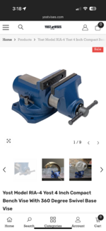

Yost has sales every so often on their website and this little RIA-4 is on sale for a great price. $36.98.
I know most here go for larger, vintage, USA made vises.. but has anybody here bought and used one for their smaller vise needs?
I haven’t bought from their site so buyer beware. I’d get one but I have the clamp-on Wilton version, bought used and cleaned up.
Here’s Wilton’s Super Junior version, made in the Czech Republic. IMG_6557.jpeg

I knew York made the small Wilton Super Juniors and suspected they made the small Yosts. I didn’t realize Wilton made Yost stop making other designs.
I started a dedicated thread on Wilton Super Juniors vises to learn more about them, but it didn’t take off.
I’ll add a post there on these Yosts.
