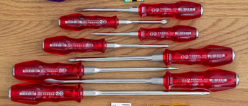

Picked up a bunch of Vessel Power Grip screwdrivers from HJE.
I REALLY like these. I believe @Dave55 has a set. I wanted to get them during the sale from HJE as well, but didn't. How is the weight/balance? I was debating these for HD use or the PB Swiss HD driver set. Tell us your thoughts.

Are these made in Japan? I think Chris (@superautobacs) said these were made in Taiwan?
Yes, I’ve got a few. Not a full set, though it might happen.
The balance is lovely. I don’t generally like striking cap drivers as I find them far too handle heavy, but these are superb.
A good screwdriver, much like a good dagger, needs to balance close to, or in front of your first finger, which these do. I think it’s the combination of the relatively small striking cap, together with the heavy bolster, that puts them right.

Good info Dave.
These are the PBS version I'm considering:
I like the grip on the PBS, but I like the size and stoutness of the Vessel caps.
Hmmmmm
Yes, I know those drivers, just don’t own any.
If it helps, the Vessel are definitely made in Japan.
Some of their cheaper drivers are made in Thailand I think, but not these. Not the Megadora either. Think one of the ball grip designs.
Note that the Torx and hex are not striking cap though.

One of the problems I have is that I have so many drivers to choose from.
I have older, well used, British made Stanley’s for rough work. I’ve got some French made Britool for “mid range”, then a choice of Snap On or PB Classic at the top end, depending on whether I want Imperial or metric.
I’ve got a few Megadora’s in my secondary box, which are superb for JIS, some PB Multigrip in my woodworking box, and some Heyco made CK for household / property maintenance.
If I was buying again I’d probably buy the Vessel Powegrip in place of one of the above, but I can’t really say which.
Don’t think there would ever be any “buyers remorse” with the Vessel. Quite the opposite to be honest - when I handle them there’s definitely a “wow” factor.
I’ve traditionally preferred the PB Swiss blades. They definitely fit better being hollow ground - provided they are matched to the appropriate screw slot. Vessel might be better for “general” use.

The Vessel Armor Grips are made in Thailand. The handles on these have the same form as the Hozan JIS-4 screwdrivers except they are "Ergonomic Soft Surface Grip" vs the Hozans that I believe are hard plastic.

I’ll be a contrarian about the Vessel Power Grip - I’ve got just one, the 6mm x 100mm flat head. I really don’t like it. The handle and balance are solid, but there’s something about the handle that is just too small for my hands.
I’ll offer, I like the Megadora line, and believe it or not I really like this Anex 7920 I bought on a whim, especially for electrical work and building PLC cabinets. Feels great in the hand, spins, solid tip. You can really get good torque with the ball. Looks goofy but it’s my go to.
I try not to do live work but through tang screwdrivers and electrical work seem like asking for trouble.
I'll agree with @Dave455, the balance is excellent. Weight wise, they are heavier than they look. Very solid and all around top notch quality.
Vessel makes a line of these called the Ball Grip. I have a ratcheting one that is quite nice.
