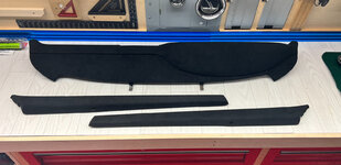

While the gauges were out and the dash partially disassembled, I made arrangements to have the dash top and door panel caps repaired and recovered. Stock is LPIM vinyl over a foam and metal reinforced substrate. I did not love the vinyl and I have always appreciated performance fabrics like Alcantara. The first car to have Alcantara was a 1974 Lamborghini Bravo.
Having a background in automotive fabrics, I studied options, consulted an 'expert' and then I called a friend from my past life in the automotive industry. He had a perfect solution in inventory and hooked me up with a product you might find in a few supercars from the present and recent past, including Porsche. Appearance wise, it is similar to Alcantara but has a slightly shorter nap, so witness marks (see pic above) are much more subtle. Performance wise, it meets or exceeds OEM standards. This fit well with my wish to keep performance and design elements close to stock looking, at least for the casual fan. I took the parts to a very well known and respected interior trim shop, Classic 9 Leather Shop. While they specialize in Porsches, they work on all kinds of cars. They happen to be in my proverbial back yard, just 25 miles away. I spoke with the owner, toured the shop and struck a deal. I could not be happier with the results.
As for appearance in the car, it works for me. I have a few yards of material left and I'll have a few more parts refinished in it to present a more cohesive appearance.
