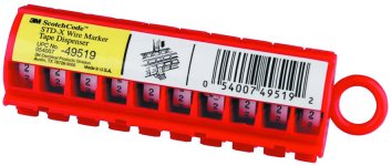

WOW! I had no idea colored zip-ties would be such a popular conversation piece. You guys continue to amaze me at what you pick up in the background of photos. Things I never would have imagined get brought into question and to the surface that are not even on my radar of things to discuss. I love this forum and how observant and inquisitive the members are.
That being said, I had posted about a year ago pertaining to zip-ties after I had performed some impromptu testing of a couple different brands of zip-ties and then purchased bulk so I should be set for a few years, maybe.
I never thought to include the POS HF colored zip-ties just because I don't think they hold well and solely use them for identification purposes, nothing more. They seem to stay put quite well until the task or job is completed and then I simply cut them off and no one's the wiser. In the past I used one of these 3M wire marking dispensers and although they work well on nice clean and fairly new wiring looms, any grease or residue on the wire or loom and they don't stick for ****, resulting in labels falling off and then wondering which wire went where. I would take note of the # and write it down to know where various wires or connections went, but now for the past several years I have been doing the same thing with the colored zip-ties, just writing down on a scratchpad or job notes which color and which size. The HF bag of colored zip-ties was like $9.99 and lasts a long time, whereas the last time I ordered one of these 3M dispensers they were over $50. I will usually write something like LO for "Large Orange" or SP for "Small Pink", etc. for the corresponding notes to connection points which keep things short and sweet without writing out long descriptions as there are a large and small of each color zip-tie in the HF package.
Here is the 3M label dispenser that I have used in the past.

Have you looked into or use any of the heat shrink label makers? I use a Brother label maker and Brother heat shrink tubing that it can print on. Made the last trailer I rewired for a friend much easier to ID down the road. We will see how long those tubes are readable but was fast and easy to print out labels and shrink them on to wires.
IH did the same thing as Monaco, the wire numbers correlate back to the circuit number on the schematic. Schematic shows circuit number - wire gauge which is nice. Too bad they didn't put nearly enough numbers on the wires and rarely do any of the numbers hold up over time. My current '66 800 has some of the numbers up by switches and bulkhead connectors but that's it. Not many people understand that, even though it's right there in the FSM. Knowing what gauge to use has made some of the temporary wiring I have needed to do for the inspection coming up super easy.
I like the American Autowire harnesses I have used in the past.
I have looked at the heat shrink label makers, but only for a full build, not really a consideration for normal service work where I'm just trying to mark something temporarily and then want it removed and back to OEM appearance once the repair is complete.
