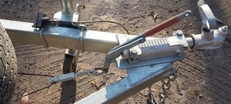

Ralf I'm not sure what the correct term is, but the trailer is braked mechanically via the coupling of the trailer itself, like this set up below. The mini still uses the original cannister style oil filter, absolute pain compared to the modern style ones. Without taking it apart yet, engine builder's guess is bearings. No turbo or straight cut gears, will stay as just a cruiser - but 60s inspired so twin SUs, finned rocker cover etc. - the kind of thing a young bloke in Australia might have built, being inspired by the mini racers of the day mixed with a bag full of Aussie speed parts and 60s 'sports custom' style.

They're usually just called override brakes, guys. Towing vehicle slows down, trailer tries to keep going pushing on the lever which tightens the cable going back to the drum brakes on the trailer. There's another hydraulic variation which has the override acting on a push rod into a master cylinder. Properly adjusted and maintained they work OK but electric brakes are way better and can be operated independently of the towing vehicle's brakes.

Yep, I have built or modified a number of trailers with brakes over the years, mainly electric for the reason you’ve mentioned, but also to allow ‘fine tuning’ via the brake controller for a range of tow vehicles in the fleet - and to eliminate the need to flip over the lockout when reversing.
Surge brakes are another common moniker.
