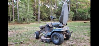

At times I need to move a vehicle or small utility trailer empty and full about the grassy yard. Lawn tractors are apparently undersized and I've no need for a compact tractor.
I've seen tools about the size of a walk behind mower that use car batteries that can move large camper trailers about but that is on a paved surface. I suppose the tires would spin in dirt or grass.
For the moment i use an electric winch but it usefulness is limited by the length of the extension cord. The come along is impractical.
The budget doesn't allow thousands. $2k max.

I have what I guess would be classified as a large lawn tractor. Like the largest you might find at Lowes or HD. It has no problem moving my 900# 5' x 10' utility trailer. Even w/ 50" sections of 12-14" tree trunk it can still move it across the lawn.

I have used my lawnmower to move my 16ft tandem axle trailer , even with a light load on it. I just make sure there's not too much tongue weight.
For my RV or my 20ft 14k trailer i use the tractor.

A lawn tractor or riding mower will have trouble moving a vehicle unless the conditions are ideal. Damp grass, holes and bumps, or up hill and you'll be spinning tires and tearing up your yard. A trailer is less of a problem due to tongue weight on the mower tires. Keep in mind that a lawn tractor is much more suited to that weight than a riding mower, but are a lot more money typically.
$2k is bottom of the barrel, but you can find a 4wd Four Wheeler for that price.

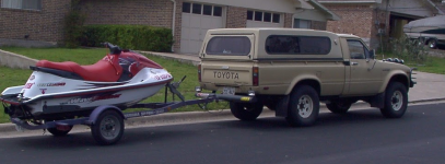

ATV? Probably has more tow capacity than my 1981 Toyota. I "mostly" tow with a Polaris, but 1500 lbs is nothing... It's the in and out of the parking situation that matters. In 1/2 ton, hella maneuverability with a front hitch.
Or seriously: Cut a deal with the neighbors... If they have the equipment.

My garden tractors have never had any issue moving utility trailers. Cars are a different story.
