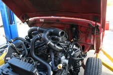

March 28th I picked up a 2011 F150 EcoBoost that was hit hard in rear.
The search had been ongoing since the beginning of March to find a suitable donor EcoBoost to swap into one of my 66 F Series Trucks.
I was able to find many wrecked EcoBoost trucks across the country and bid on a half dozen or so. Difficult to find close by that were not wrecked in front end as most were.
This is the truck I found:
This truck happened to be a SuperCab with a 145" wheelbase. Because I wanted everything up in front was not that concerned about back sheetmetal or frame section knowing I needed little of it other that the rear axle assy. This one a 3.15 geared 9 3/4" was toast from the hard rear hit.
April 7th I started to tear apart my '66 Truck to see if this was even possible.
I pulled the cab and moved it aside. I then pulled the cab off the 2011 Eco so I could use that chassis to check fit under the 1966.

Anxiously waiting to see how fit would be I rolled the wounded 2011 chassis under the '66 Cab. Much to my amazement the '66 to '11 body mounts were in proper location! 46yrs apart . . . Using the '11 mounts on '11 chassis it dropped into place, except for of course the rear of cab on the '66 was too narrow so I just kept tail of frame down to double check fit and proper centerline of front axle into wheel opening.
Also note the steering column of '66 was right in line with the '11!

I started this project 2wks ago on saturday. The initial plan was to just drop in the ecoboost engine and trans. Problem is there is not a standalone harness avail for the ecoboost yet. I spoke to a Ford engineer nearly a year ago and was promised they would have one out in approx 1yr. Well a couple weeks ago the update was: It will be at least another year yet and they plan on doing a ecoboost harness for swaps but its possible the 2.0 or 1.6 eco engines could have a harness first.
What make this complicated is the type of injectors used for the direct injection. Knowbody makes a harness and what is required is most of electronics as the F150 has Securilock anti theft and a bunch of other **** in order to make truck even start. This truck has the upgraded instrument cluster so it would be an issue unless everything is up and working.
So my plan simply changed because I did not want to give up on project as really love the eco engines.
Once I found that the engine position in chassis was going to work and cab spot was close with stock mounts I then decided that maybe I could install the 2011 dash into the '66 cab to make it a plug and play. Problem with that the '11 cab is HUGE in length and height compared to the '66. The '11 seats I planned on using would nearly touch the ceiling in he '66 cab and just looked too far out of place. Remember the '11 Eco only has 6430 miles on it so the interior was pretty much mint and not damaged with exception of the side air bags. Seat and dash bags did not deploy making this a good candidate for the swap.
I found that the 5.0L Trucks were avail in a 125.9" wheelbase so it got my brain turning that maybe I could just pick up another frame. Using my frame stretcher to get it to fit my 129" Wheelbase '66.
I took a HUGE chance and ordered a NEW 5.0L Frame from Ford as the only thing in partsbook was wheelbase and did not mention engine size. I figured if I had to I could just use the mounts off the original frame and already had them just in case.
In the mean time I removed the floor out of the '11 thinking it would be best to use that so the dash, HVAC etc would be a direct bolt in.

Even if I have to compromise on what I really want to use to save $$ since I have the entire '11 truck on hand.
Next up is fitting the '66 Cab to chassis to find firewall location etc. I have started the cut of back of '66 cab to fit the chassis. Goal is to make it look like it belongs that way. All metal finished of course...
Rear cab mounts I think I may have figured out by moving the cab mount from outside of frame to inside.
Another issue is the height of frames from '66 to '11. I do not want much if any of the frame to show when looking from the side. I need to section the cab to do that. Exact location unknown. If the floor is raised it will even make for less room for the '11 dash.
More real soon!

Sure learning a lot about the 2011-12 F150's! Pretty much taken completely apart at this time.
I have 3 trucks torn apart right now so what a MESS! not much for elbow room in such a small garage. Getting too hot for much outside work.
This is where I am at right now with cab mod in back. Frame no fit but a little massaging should do it.
