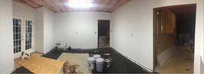

Very slowly making some progress. I got it primed with some kilz. I underestimated how much I'd need, I got 3 gallons thinking the 2nd coat would go on thinner than the first, but it didn't, I needed a full 4 gallons. But I decided I didn't want to run back out for another can on a work night. So you can tell the one wall I ran short on. I guess it will get an extra coat of color. (Edit: actually in these pics you can't really tell which wall has 1 coat. It's the wall with the exterior door)
Speaking of color, we have a ton of left over paint from the house. When they come to do final punch list and touch up in a few months they will bring new paint. So since I have this and I don't want to store it, I'm gonna use it to paint the shop.
Most of this **** needs to go in this space. Some of the cabinets will end up back on the garage. And I think I might make the back side of the bar wall into a lumbar storage rack.
I'm also slowly replacing the incandescent fixtures and 40w bulbs with 4tube 4' t8 fluorescent wraps.
