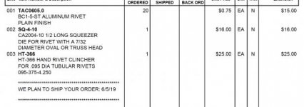

Radar- I feel your pain as far as the engraved data on that plate. Glad you and Matt worked something out.
The rivets I used on this are indeed original type rivets. I redid an old Craftsman tool box and wanted to use an authentic method to re-attach the Heritage logo. I contacted Hanson Rivet and Supply, talked to one of their guys and he steered me in the right direction. Minimum order for rivets was 15 bucks so that equated to 200 or the suckers. I also got the setting tools required to secure them without flattening the heads. I think it turned out great and looks so much better than the "pop" rivets set with a gun from the box stores. Fortunately the length of the rivets I hoarded for the tool box worked with the grinder so it was win/win for me.
If you choose to contact Hansen, they'll need the diameter of the hole along with the thickness of both surfaces to be mated. If you're not in a hurry I'd be more than happy to send you a half dozen rivets, that'd leave you holding the bag for the setting tools if you don't have something that'd work for that purpose. I'm away from home with work right now and probably be a week-10 days before I'm home. I think I may still have the invoice that I could give you the parts numbers for the setting tools as well.
Looking forward to seeing your pre-block when it's done!
https://www.hansonrivet.com/rivets/know-your-rivets/
EDIT: Actually had the invoice in my email. Came to 56 bucks which is a lot for one project but I've now done 4 grinders and a couple of boxes so it pans out. If yours is a one-time project shoot me a PM and we'll work something out.

Jo--
You're right, that's pretty pricey for a single application. However, I expect I will find other tools in the future that will benefit from re-riveting. So, thank you for your generous offer, but I'll look into getting a new tool. :rocker:
One point for clarification: you say in your post you bought 200 rivets, but the invoice says 20. Slip of a zero or do they come in packs of ten?
