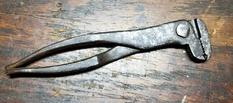

I snagged this tiny Baxter Patent at the flea market this morning. I'm going to keep it with Big Brother on my 1899 Metal Worker article display panel for now. More on these unusual adjustables and a link to even further reading in post #1.

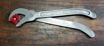

I recently sent GJ member bbbarracuda an Armstrong 5/16" square machine wrench for opening and closing the chuck on one of his antique wooden hollow-handled multi-bit tools. I was not expecting anything in return, but he sent me something that probably makes the blind trade a little lop-sided in my favor - a c. 1928 Wade Wrench Company adjustable wrench!
Marked 'WADE WRENCH CO WHITE PIGEON MICH' on the brand side...
...and 'DROP FORGED PAT'D' on the flip side.
Anything from a place with a name as cool as White Pigeon would be an instant snag for me, anyway, but it's even neater that it's an early adjustable (plier or self-adjust type category).
Wade described it in his patent as an easy adjustable wrench designed for gripping wire, small rods, and nuts of various sizes (the capacity is quite large), as well as easy to ratchet (quick release, quick re-grip method). He was very proud of the flush pivot, the ********** style handle action, and the low profile, which I have to admit, with good reason. They are all great features. This wrench is as well-made as it is handsome.
Patent is 1,677,909. See last pic for patent diagram summary I appropriated from DATAMP, and see more info at the DATAMP page linked here.
DATAMP does not provide an explanation for the F-Circle markings at the end of the handle, but I suspect whoever it belongs to was the foundry Wade used.
According to the GJ search engine, the only mention of Wade Wrench Co on GJ is in 4.c's Mfgrs List thread, linked here. Which makes this a FOAK here. So consider my fancy tickled.
I attached a few additional thumbnails below.

Nice example.
I crossed paths with the Wade patent while researching this similar mystery wrench at the top here. I grabbed one to compare to but never followed up on that thread with the Wade topic. 143CC0BB-CCEB-4A4F-9201-4D5A4A102786.jpeg

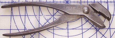

Diamond Wrench Co.
”nut and buggy wrench”(as called on Datamp)
8-1/2”
Inventor - Henry A. Thompson
marked STEEL FORGED PORTLAND,ME
There‘s diamond stamped on the opposite side.
Found this at an estate sale some years back.
Far from a good example for the markings, but it works great!
The dynamic jaw slides freely and tightens with the wing nut.
No evidence of a spring on this model, as seen in related patents.
CAC9B8CF-C3BD-4FF4-A887-F920D491BC9A.jpegE2AA847E-4E2C-4C76-95F3-C73F2631F009.jpeg65A995E6-B80D-4B8A-97E6-EAA360FDC994.jpegD4767096-4478-4E2E-BDC8-CB75BCD4BBB9.jpegD82B7FAA-498B-43EE-A8AE-A9AD47C28220.jpeg

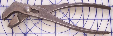

11,979
Thanks Lugz. That was a lucky find, as was this. Quite far from museum quality, but also great functioning, this flea market find from a couple years ago.
Fowle & Co. of New York, NY nut wrench, referred to as the Hewet Union Wrench.
The markings on the top jaw are quite faint from pitting, just barely identifiable, and not really visible by photo.
Patented in 1864
Inventer Henry Wheaton Hewet
The “fluted” portion of the handle turns, adjusting the bottom jaw.
174EA616-216D-49B7-B344-6AFFF59F4BAB.jpeg360865DD-E8E9-46AC-8CEA-34C27F2C85EA.jpeg57C24A47-63CC-47BA-871E-1F37A9C9DFB5.jpeg9256698C-CFB8-452B-91E9-40A320A5C8CD.jpeg
