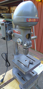

Bought this old Homecraft DP at a g-sale super cheap because it was missing the chuck. It was missing the chuck because it had the scarce optional spindle for 1/2" shank router, shaper, sander bits. I found a JT33 spindle online and already had a couple chucks.
It cleaned up exceptionally well. Acetone worked well to clean off the old grime and paint overspray but didn't harm the factory finish.
I totally disassembled the original motor and cleaned all the parts, flushed out the old ball bearings and replaced with Polyrex EM lubricant, polished the centrifical switch, replaced the cord and switch. I also replaced the rotten belt with a link belt.
I measured the runout at the spindle and the indicator didn't even move .001". For compact benchtop DP's, these Homecraft machines are pretty sweet.

Dave...beautiful job keeping that thing in service. Nice job!

That is a really nice looking DP Dave. You did a great job restoring it.
