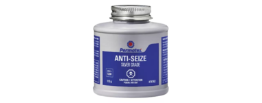

So Permatex brand I am convinced is making things super confusing to buy from them. Way to many versions of the same thing.
I currently have 3M Copper and its great stuff but more so for Brakes, Sub frame bolts, Electrical conductivity etc But I am reading more and more how it should not be used into aluminum due to the reaction with copper etc.
I was going to invest in a "Grey" version of Anti Seize to have with the Copper in my tool box.
So it turns out regarding Permatex brand.
If you see the version "Anti Seize Lubricant" or if you see the version called "Silver" or even the version call "Aluminum"
these are all the same thing, which is a mix of Aluminum, Copper, Graphite.
So basically if you have the copper version like I do the ones above are the same idea.
but if you see the version called "Nickel". then this version will not be a mix of items like the ones listed above and the correct product to use when screwing into Aluminum, Titanium, SS due to no copper content.
Am I right or out to lunch? I would like to learn whats the correct item to use.

I originally purchased a bottle of Permatex copper anti-seize and I used it for almost everything without thinking much about it. Over time, I ended up finding the regular and nickel versions at garage sales, so I now have all three. As a result, I did a little research into them a while ago to see which one works best for different circumstances and saved my findings for reference purposes.
This is what I found out-
TheK” factors (for determining bolt torque reduction) were determined by Permatex by applying anti-seize to the threads of the bolt and also to the bottom side of the bolt head or both sides of the washer (if one is used).
Permatex regular anti-seize-
SDS link- https://www.permatex.com/wp-content/uploads/sds/80078.pdf
This is the cheapest stuff, and dark gray in color. It has graphite, and aluminum as the main anti-seize agents according to their 2020 Safety Data Sheet (SDS), but for some reason their website mentions it also having copper in it so maybe it's there in trace amounts? It works up to 1,600 deg F. This is the one that should be used 90% of the time or more. According to Permatex, it is electrically conductive and it can be used with aluminum, or other soft metal threads. It is listed as being safe for use with stainless, but copper or nickel anti-seize are both better options when dealing with stainless steel or high temperatures. Torque needs to be reduced by 10% compared to dry thread torque specs. (K factor 0.18)
Permatex copper grade anti-seize-
SDS link- https://www.permatex.com/wp-content/uploads/sds/09128.pdf
This is the mid-priced stuff, and it's dark gold in color. It has copper and graphite as the main anti-seize agents according to their 2021 SDS. It works up to 1,800 deg F. According to Permatex, it is electrically conductive and it can be used with aluminum, or other soft metal threads. This is the type most recommended for use when installing spark plugs in aluminum heads and for use on exhaust studs that thread into aluminum heads. It is also listed as being safe for use with stainless, but nickel type anti-seize is better for any stainless being threaded into a harder metal like steel or iron, because there is less of a chance for galvanic corrosion over time. Permatex copper is the best option for threading stainless fasteners into soft metals like aluminum (a stainless gun barrel threaded into an aluminum receiver for instance). Regular anti-seize (the cheap stuff) is also rated for stainless to soft metal threads, but that formulation has aluminum as one of the main anti-seize agents. Aluminum is often not very good at preventing seizure of stainless fasteners, so that’s why copper anti-seize is the better option. Torque needs to be reduced by 20% compared to dry thread torque specs. (K factor 0.16).
Permatex nickel grade anti-seize-
This is the mid/high-priced stuff, and it is medium gray in color. It has nickel and aluminum as the main anti-seize agents according to their 2019 SDS, and the formula is copper-free. It works up to 2,400 deg F. This is the type most often recommended for use on exhaust manifold bolts/studs when they are threaded into iron heads, for oxygen sensors, and for all turbocharger related steel or iron connections, exhaust system or catalytic converter slip fit connections, and exhaust system bolt threads. It is also the one to use when copper contamination must be avoided. Nickel grade anti-seize also has excellent chemical resistance compared to the other two formulations, so nickel is the preferred option for extreme chemical environments (like constant humid chemical laden exhaust system air). According to Permatex, it is electrically conductive and it is often the best choice for use with stainless, but it is not recommended for use when threading into aluminum or other soft metals. This seems to be because nickel is a fair bit harder than metals like aluminum or copper, so if placed between softer threads it might actually gall the softer threads upon fastener installation/removal instead of preventing galling. Nickel anti-seize is the best option for things like stainless-to-stainless or stainless-to-steel threaded parts. If stainless is being threaded into a soft metal like aluminum, use the copper anti-seize instead. Nickel anti-seize is also the best choice for use with titanium and nickel alloys (like Duranickel, Hastelloys, Illium, Monel, etc.). Torque needs to be reduced by 35% compared to dry thread torque specs. (K factor 0.13).
