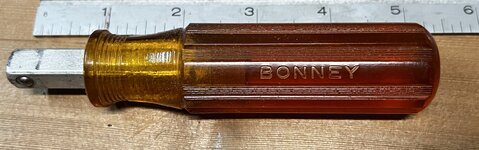

Thanks. I see it in the 1941 catalog. I already shocked myself by unexpectedly finding one in the 1941 Bonney catalog. I'm pretty sure they weren't in Williams, Plomb, or SK sets, so, not all personal blind spot, but at this point I am hedging everything I say on this topic! I may have to put this on the '23 'to do' list for research. It still seems uncommon to me in that drive size, and I guess they were to some extent, since their apparent scarcity is the premise of Beemer's thread. But now I'm more curious than ever.

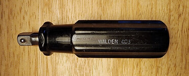

I have a black-handled "Walden 403" that is a 3/8" drive and 4.8" long. That is all that it says - it has no "Made In U.SA." or any other markings. Did Walden ever sell imported stuff?
