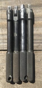

I figured that I should put my two cents worth in on the hinge handle markings. Here are the results of the several I checked.
All of the cad ones I checked had the upside down W45FAFC28-2AFE-468A-A025-3481693846FD.jpeg
The four black ones split between a right side up W and an upside down VBC9CE30C-9B3E-4AF7-A2F5-8FE1931C7D5F.jpeg
I didn’t see any additional letters on this style.FB6F5C5E-C7F5-43F7-8B9C-E96EB692707D.jpeg380AD3EE-3CB4-4E85-A987-978E1C1D391A.jpeg

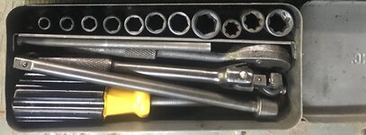

Although I have quite a few Walden 1/4” drive tools, I had never run across a 1/4” drive speeder. I solved that by picking up this formerly rusty example on eBay. It came out of the evaporust yesterday looking pretty presentable. Based on the finish, it could well be wartime. 972E0773-4EDA-4C45-A8C7-BAFFF69EEAC0.jpeg2C5D79E0-6A64-484C-A753-8695933B8BC2.jpeg2581626E-1D4C-42A5-93BF-F1D8D4D73488.jpeg71B1C94A-E346-4B69-A1A1-23580956AC6C.jpeg8A1D9129-5073-4FCD-9345-19A5332EFB67.jpeg

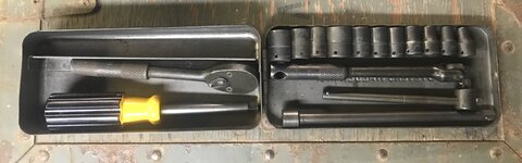

Although I’ve been trying to cut back on buying 1/4” Walden sets, this set was priced quite a bit under what they normally sell for and looked like a partial late WW2 set specified from 4/45 through the end of the war. I only had to add one 5/16” 8 point socket and breaker bar to complete the set although I did move it into a nicer box that I had on hand. It didn’t include any sockets with the upside down V or detent ball holes.91C01BD7-CAE3-4022-84DE-182AEAD6D57C.jpeg4B0955D7-340D-450A-906F-966D677DA041.jpegAA8A03EF-B9AB-417D-B0A9-A2C998E3091A.jpeg8FB8583A-0F3B-41CA-AF47-06856BE70933.jpeg

I was happy to spot this on a buy it now. I grabbed it as fast as I could because they come up so rarely. They are the spinners shown in the 1944 catalog. I added it to the rest of the Walden stuff I’ve accumulated over the summer.
-Don403509B6-BCD7-4F6F-B9DE-6B1DCE3E5ED8.jpegD1EF2CB2-BE2F-4A0A-A378-9C4318E16AEC.jpeg

I bought this Walden lot on eBay to get the hard to find yellow and black spinner. As an odd coincidence it came with a knurled 6 point 7/16” socket that I had been looking for for years. I suspected that it existed but had never actually seen one in person. All of the other knurled 6 point 7/16“ Walden sockets that I’ve seen in person have Walden Worcester in a line rather than one word above the other. There is a collector in the UK that has one similar to this new one.92FAE065-2064-4802-9D20-68B2539B4414.jpegAE2F2F73-A8CA-4DB3-ADB9-E3ABCAEFBB59.jpeg2E8D5F17-5F9E-4A5C-9F82-9DCE72A37418.jpegE325452F-287C-4EC5-98CB-DF1CEA238B5D.jpeg8006E99F-9B2A-4786-83E0-51F3BA28354A.jpeg4E037346-6943-4DB0-B8A4-4DBE32600F4B.jpeg
I added matching tools to the new box and sockets to make a complete set.4DB32BB1-3938-42BC-8510-ECBFF49AFB8C.jpeg33453473-0F60-4E6B-955E-1D1086518B3B.jpeg
