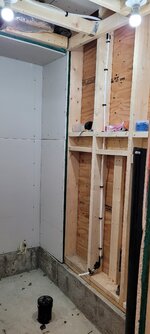

I have gone as far with the drywall in the bathroom as I can for now, the one wall and ceiling will have to be finished later after the plumbing and remaining electrical is done. But At least ita progress even if its incremental.20230227_100620.jpg
In total I've used about 6.5 sheets of 4x8ft 5/8 Type X drywall in the bath and mechanical rooms so far. I've tried to be fairly effcient and not waste since its fairly expensive and also hard to dispose of. This is how much total drywall waste I have so far...

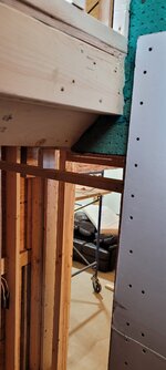

With the bathroom project as far as it can go for now I turned my attention to the stairs... The stairs have been an issue a few times, and while my contractor did come out and fix the rise/run and out of square issue himself, and I'm greatful he showed the integrity to do it after I had paid him out already. When I was planning out drywall and sound board for the stairwell I found another issue...Sigh.
So normally at least from what i've seen the framers leave a gap on either side of the stairtread so that you can just slip the drywall down and have it rest on a 2x6 that is sandwiched between the wall and the stringer. And I had told both my contractor and his guy that built the stairs the first time to please leave a 1.5in gap from the wall to the side of the stair treads (since I need (1 3/8 min), which they both aknowledged. Well when I measure the gap guess what it was only like 3/8in. I proabbly should have checked earlier but forgot and assumed they would build it as I asked. I imagine I could ask them to correct it but honestly its just easier to fix it myself at this point.
To make matters worse the stairs are all put togther with 3in sprial rails and construction adhesive so there is no taking it apart nicely and triming things then re-assemble.
Anyway its a less than ideal situation i've been left with to solve the problem. So I decided the best solution would be to just measure it out and marke a line then just cut the treads back to the edge of the stringer as best I could with my sawzall. Its Not perfectly pretty but the stairs will have carpet on them if this turns into guest quarters and if it stays part of the shop no one will care if the treads have perfect side edges and at least now I won't have to 'sculpt' the drywall and sound board around all the treads.
My plan worked well on 3 of the 4 areas I had to trim back thr treads on the side.
Sadly the stringer on the one side of the upper stairs after the landing was too close to the wall to get the 1.5in gap I wanted and 3/4in was all I could get but at least I can get 5/8 drywall in there and I'll just double up the sound board on the shop side to retain the sound seperation. (see picture below)

What is the rise and run on the stairs? There is a ratio or rule for the rise and run. I use the "Rule of 25". It is 2 x rise plus the run should equal 25. So a 7 - 11 stair is (2 x 7) + 11 = 25.
This is why 7 inch rise with a 11 run works and is popular. But it is not the only ratio that makes comfortable stairs.
Cement guys (flatwork guys) can only do 7 - 11 stairs it seems. Even if it messes up the height of the landing. Low rise and long runs are done in building entrances and are quite comfortable. On my decks a couple of houses ago I did 5 1/2 rise and 14 inch run. Made it easy to not spill your drink!
Anyhow, some smart person figured this out and it works with your natural gate. Code may have 7 - 11 and the steepest stairs allowed now.
So curious how yours are going to work out.

Just measured the stairs they are in an L-shape with a landing halfway up they measured out at 11in deep treads (run) and 7in rise. The stairwell is currently 42in wide but will likely end up righy around 40in wide once drwall is all done.
The stairs on my 1970's era home are only 36in wide with a steeper rise/run so I think these ones will be fine.

Following that I did filled the outer two stud cavities on the sheer wall in the bathroom with rockwool, followed by sono-panel and drywall.
I did this in the bathroom, because of course I can't finish the center until the plumbing is done, but I had just enough 5/8 drywall left to fill the outer sections with little waste and the remaining unfinished center is 48in wide so I will be able to use materials to effciently finish it later.

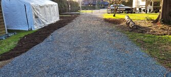

We finally have a few good days of weather, finally! So i have taken a small break from the inside work and used what time I had to begin tacking some of the unfinished yard issues that remain from construction and I was unable to finish due to non-stop snow and/or rain for almost 6 months.
As you may recall back around Novemeber of last year we got some snow followed by a series of heavy rain storms and noticed that the hole I had left against the foundation where the sewage pipe terminated had filled with water, which was running back from the adjacent lawn (well, a mud field actually) that sloped towards it and also from the downspout at the north east corner of the shop. Worse yet this fast rising puddle was right next ro the northwest man door that was only a few inches higher.
Some of the problem i'm sure was due to the whole adjacent area of the lawn having no grass so the water just ran across it easily (towards the north shop wall), even though I had seeded it 6 weeks or more prior.
To temporily fix the drainage problem I filled in the hole around the sewage pipe (will have to it dig out again when I do the septic), added some gravel around the door and then dug a couple of shallow 'ditches' to direct the water out back (east of shop) where it could drain to the south side of my property which has nearly pure sand for soil.
These tempoary solutions worked perfectly. However, I originally planned a complex series of drainage solutions for this summer. And I say complex because there is no ditch on my street nor storm water etc... and I can't knowingly direct a whole bunch of water onto any of my neighbor's properties either, so any drainage would have to be fully contained on my property. The ace in my sleeve is the soil under most of my property is quite Sandy, with the exception of some clay in the back north east corner. I should mention to that my property although it at first looks flat slops north to south and to a lesser extent east to west.
Anyway all that seed I spread last sept and early oct did not amount to much, no rain from july - mid oct and then late oct we had snow and cold weather for a bit etc...
For sure some grass is starting to grow but, not much given how much seed I spread and it being 6 months later. I just re-seeded it all yesterday evening and it rained overnight before getting sunny again today, hope the new seed takes.

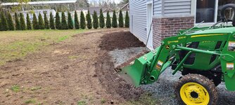

After thinking about drainage, I decided that perhaps I could avoid a whole lot of work and expense on drainage by just doing so re-grading. So I carefully hand dug a 'gentle' drainage swail where my temporary ditch had been and made the grade around it very gradual so I can still mow over it then seeded with grass. I think it should work well.
The slope into and out of the swail is more gentle than it appears in the picture and the total depth is no more than 3 or 4in.
Next up I had been 'composting a pile of black berry roots and surrounding top soil since early last summer, hitting it with round-up to kill any new sprouts and then left it alone since oct, took some dirt from there which looks like fantasic rich soil now, and spread it beside the north wall of the shop, with a gentle slope away from the shop, this created a 'low channel' about 6 or 7 feet out from the shop that the yard can drain to which will flow west out into the yard next to the driveway where the soil is almost pure sand and will drain well. I believe this will work well.
I haven't yet seeded the new soil right against the shop because I need to first decide should I add gravel and make it a parking space, put a flower bed for asethics or just turn it into lawn which is cheap and easy...But will decide soon.
Here is hoping my very simple and free drainage solutions actually work as planned.

I forgot to mention in my last post I was also able to eliminate the last of the leftover dirt from construction and filled some low spots in the yard.
I'm going to need some more grass seed!
Love the Tractor, it makes what would have been a huge project a fairly quick and easy thing for one person to accomplish!

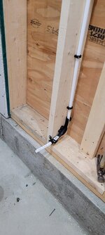

I have also been putting some thought into getting the rockpit for my floor drain done as spring is approaching. I was browsing the local classified adds and found a nearly free ($10) plastic 55gal drum and picked it up.
My tennative plan is to drill a whole bunch of 5/8in holes in this drum, fill it with drain rock, wrap it in water permiable landscape fabric and hook it up to the floor drain pipe where it terminates out front of the shop. The whole drum will sit inside a little bit larger hole that will also be filled with drain rock and encased in landscape fabric.
I'm hoping this 2 layered approach will provide good longevity against the rock pit getting 'gumed' up with silt etc... And doing it this way will be inexpensive as i just need maybe a yard of drain rock and a roll or two of landscape fabric.
I'm open to suggestions/ideas if anyone has them???

I don't think there is a need to fill drum with rock. I would just line the hole with landscape fabric, then put some rock in the bottom, then set the drum in (with holes drilled), then fill around with rock, then fabric and dirt on top. I have helped install a few 55gal drum septic systems (shops and hunting camp) and this was the way we did them, and they are still running fine.
Those rooms should be super quiet to the rest of your shop. It all really looks great so far.
kj_mustang
Feb 9, 2011
1,221
Harrisonburg, VA
Agree, I installed a NDS plastic dry well that holds 50 gallons that is connected to my building's gutters. Instructions for it were no gravel inside and at least 8" soil cover on the top. I would put the fabric around outer hole, then some gravel in the hole, and then fabric around the barrel before setting in the hole, then fill around with gravel, cover top of hole with fabric and then soil.
Thanks Kindly, yes I hope the Sound deadening work I did will help to at least have a decent level of sound isolation, especially from the air compressor.
Yes, that is pretty close to my plans.
Ideally, I agree the drum wouldn't need to be filled with rock and that would provide more 'reserve capacity' too.
My Thinking in filling it, is that it will be located under the parking area so I don't want it to collapse if its driven over, and even if I move it to under the lawn, I would still be conerned about a collapse when I drove my tractor over it to mow the lawn. I might instead of filling it with drain rock, fill the barrel itself with some 6 - 9in crushed stones I have left over from a landscaping project, I think they would take up less internal volume and there would be a lot of air-space between them while they still create a weight supporting medium. I would still fill the outer hole with drain rock.

Maybe he will chime in here, but a friend of mine buried a plastic drum under his 50x50 shop slab for the snowmelt gutter.
He plumbed the boiler condensate drains, bathroom floor drain, snowmelt trench, and central shop floor drain all to a 4” pvc through the center of the lid of a plastic drum down to the floor of the drum. He drilled holes in the pipe in the drum and in the drum itself. The drum was surrounded by drain rock, and to prevent collapsing, the drum was also filled with sewer rock.
The idea with the influent pipe reaching to the floor of the drum was to shop vac out the inevitable sand that goes down the drain, something he has already had to do at least once.
His slab was exposed for several years as he built out of pocket, and that sump could handle every bit of the several feet of snow melting each Spring.
Since your floor is already poured, you are obviously planning to put the drum somewhere outside the shop, so I would highly recommend the drain lateral enter a tee in the lid, with an upright pipe from the tee to above ground (and vented!) for shop vac access.
At my former shop, I buried a ten foot tall chunk of holey 12” pipe and ran a 1” drain lateral from a tiny slop sink into it. It drained poorly or not at all cuz the air couldn’t exit the drywell as the water tried to gravity in.

You know having a clean-out for the drain pipe into the barrel is a fantastic idea, I will try to incoporate that, thank you!
When the plumbers put the piping for the floor drain in before the slab was poured I did ask them about a vent. What they told me, was that it would not be required if draining into a rock pit because, there are no sewer gases and also since the drain has no trap and is 3in diameter (I think) air would have no trouble escaping since the pipe itself will proabbly never be full of water.
I think in an ideal world, the 'proper way' to do this would be for the drain to first go into a unfilled concrete sump that would have the top open to the parking area with a grate and that would then drain into this barrel/rock pit. And I am still considering that but, I don't want to sink a whole bunch of money into the floor drain either, so I may skip the sump.
So I've now turned my plastic barrel into a holy barrel, so holy you could take it to church, lol. I Hand drilled approximately 1,300 5/16' holes.

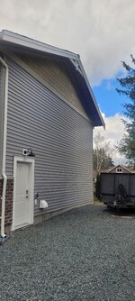

It was another beautiful day today and that gave me some more opportunity to accomplish another item on my yard work list. As you will recall when I purchased this place the back 45 or 50 feet of my entire property was like 7feet high in invasive blackerries and english Ivy, with garbage barried underneath, which I steady worked to clear in the lead up to building the shop. I also kept the land all cleared all last summer and have been trying hard to get the grass to grow so that any regrowth of ivy and blackberries can be dealt with by mowing.
However, I also wanted to add in some trees in the corner to provide privacy from the neigbor's shop with a coach house, that overlooks the back corner of my yard.
I picked, 2 stika spruce, 2 coastal douglas firs and 1 coastal western Hemlock tree. All of which are native to this ecological biome so they should be hardy and fast growing.
I also took the time to prevent a future problem on the south east corner of the shop, there was a small walnut sapling their, which would be ok except that in 20 years it would be far to large for the space and endanger the shop. So I cut it down and replaced it with Green arrow head weeping Alaskan cypress. It will grow to about 25ft at maturity but only spread 3 or 4 feet wide which should be perfect for where it is planted.20230318_163537.jpg

Man seeing newly planted trees is really making me ready for spring! I need to do some tree planting around my place this year too.
yes, it might seem a little funny to be excited about but planting trees in this corner of the property is something i've been wanting to do since we moved in, but took this long to finally get the ground ready for it. It certainly has been nice to finally start getting some nice days I could work outside after the second year in a row of unusually cold winters.
Now its time to sit back and let all the wet, temperate west coast weather growth these little trees into large ones!

Drove my Gravely Lawn tractor over mine many times. According to Tractor data it weighs 800+ lbs.
Yes, I think filled with rocks the barrel should be fine...
My tractor in its heaviest configuration is around 6,000lbs and that is without a load in the bucket or grapple and without operator weight. In lawn mowing configuration (no 3pt ballast/attachment, no loader, 62in mid-mount mower deck) would be about 4,200lbs not including operator weight. So I do try to be mindful of the weight, then again I mow over my septic field without issue...so maybe i worry to much.

I've now completed the supply lines for the shop bathroom. Made sure to use lots of pex braces and brackets so nothing ever moves. These are all 'end runs' so no joints in the walls (as I am a novice).
For now the supply lines are just terminating in the mechanical room as I still need to do the mud/tape on the drywall once the weather is warmer and after that I will get some hot and cold supply manifolds to hook them up to.
All in all so far working with pex seems pretty quick and easy, I wouldn't want to take this job on if I had to do it all in copper!

So I did a little more work on that bathroom wall...
Added Rockwool:
Then sono-panel:
Then 5/8 drywall and shut off's:
I had to cut down the ABS sink drain rough-in because it was in the way for the drywall...(4ft tall)
Apprently the plumbers who did the underslab rough-in must have leak tested the system by just filling it up to the top with water and then cementing the cap(s) on and left it like that. So when I cut it off I was suprised by a minature flood! worse yet all the other interconnected rough-in were filled to the top also so water kept coming out for a bit. Not ideal when your doing drywall! Also given that we had a lot of freezing cold weather this last winter its darn lucky the pipes did not crack, but since its full of water oviously they didn't.
Kind of sloppy work by the plumbers to leave it full full for the next guy (me) and not even say anything IMO. But that just makes me want to learn plumbing more so I don't have to hire trades anymore.
