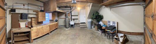

In September 2021 I was lucky enough to buy my first house. It's in the San Francisco Bay Area, built in 1952, and met the needs of me and my partner. In this thread I'll try to document goings-on with the garage and will probably veer into documenting other projects.
Here's what the garage looked like when we closed on the house.
Needless to say, it was pretty cluttered. Given that it's a 2-car (and I want to put 2 cars in it, plus tools), it was time for some reconfiguration. The first thing to go was the water heater and the utility sink. While I'd love to have a utility sink in the garage, I couldn't spare the space for it. The kitchen is right through the door and I can wash my hands there. Anything else gets cleaned outside!

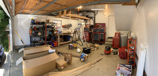

As you can see, the garage was in a pretty hellish mess at this point - so, naturally, time to buy a toolbox! Forget that I have 3 bottom chests and 2 top chests at my folks' place! Time to put that truck to work again.
You can see the rolls of insulation rolling around. Yep, time to put those in.

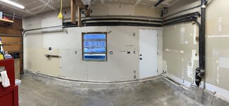

That brings us to July 2022, when I decided that I wasn't a drywall expert and that I wanted some help. Just like that, drywall was up. I did some basic finishing on the opposite wall, which had some ugly seams. This was a major milestone for me and the garage finally felt like a room and not a job site.
Got everything hooked up and charged a car from work - super exciting!
Time for paint! The drywall isn't crazy flat, so I went for a semi-gloss white. I'm still not sure whether it was the right choice. I read about 10,000 threads on the subject. It reflects more of the imperfections than I was hoping for, but it should be reasonably easy to wipe off. Whatever, it's done.
Voila! Bad photo, but it's all one color. Radical!

Having put this off for, let's see . . . about 11 months . . . it was time to actually deal with the hanging wires from the lights.
Sticky conduit time! Will I regret this? Who knows??
I shortened several of the cords, because that's how I am. I also used a laser because, well . . that's how I am!
Garage door button is back in place:
Yes, I am showing off :D
Tidied the wiring for the garage door opener again. I hope to replace this thing soonish, as it's a real hazard (no lasers, mounted in a questionable way) and it's loud.
Here's the finished result. So much better!!
