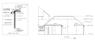

Hello again, it's been a while. I decided to start from scratch on my 2-car garage as seen in previous posts. After many sleepless nights dreaming of the ultimate garage with 4 bays, skylights, lifts and the rest, reality hit when I started shopping for quotes. In the end, I decided to do a modest upgrade which maximizes the 2 car layout and fits the neighborhood I live in.
Design
I met with an architect and we designed a better space - taking my existing 22 x 21 slab, and lengthening it by 2 feet. This would allow my tools and bench to live at the end of the garage, rather than on the side like it was before while giving space at the hoods of the cars. I also wanted a flat floor to make the driven part of the floor space to be wider and so that I can space the cars further apart when parked inside. The existing slab had a sunken area for parking that is to be filled in with concrete. The flat floor is also better for using a maxjax lift.
This garage will remain detached, but now the area leading up to the garage door will be covered. This serves three purposes: shaded parking , cooling for the inside, and lofted storage above the parking area. I will be installing two mini splits inside the garage with an exhaust fan in the roof. The cooling operation is as follows: open the garage door, turn on the exhaust fan in the roof to purge hot air at the top (the open garage door will bring in "cooler" air from the shaded parking area) for a couple of minutes, then close the garage door and and the exhaust fan and fire up the AC mini splits. In my mind, this would purge hot air from the garage and allow the AC to cool the space faster. For days where i want a draft without AC, i will simply run the exhaust fan with the garage door open. This of course means that the garage will be insulated.
I think this approach is budget friendly and will add to the value of the home without going too much overboard and giving up some of the money invested when it comes time to sell and move. I have some swap plans in the future and I am really excited about the shaded parking while i have a big project in the garage.
Plans:

Section view
