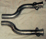

@Xti04, I feel like we are living parallel lives. My first welder was a HF Chicago Elecxtric $80 flux wire. First welding cart was a plastic sawhorse. I needed header adapter pipes for my big block Corvette.
Decided to make a complete stainless exhaust and after local welder wanted $500 just for those two pipes in stainless, I bought an Eastwood MIG 175 for $499 and put it and the flux wire welder on HF's cheapest cart. Got a small tank of 98%02 /2%AR and made my own franken-system. Pair of 3" Header pipes that necked down to a 2.5" Magnaflow system with two mufflers and I had so much fun I cut the system up and made a quad center outlet exhaust with a single muffler with dual 2.5"-inlets, an X-crossover inside and dual 2.5"-outlets. Fearing it would be too quiet I added a pair of electric cutouts that exit under the differential.
Eastwood MIG175.jpg 72 corvette magnaflow exhaust 16841.jpg Exhaust System Final.jpg Close to Finished.jpg
Had the crazy idea to try fusion welding and bought an Eastwood 200DC TIG (also $499) and put it on the bottom shelf of a second cheapest HF cart with the Eastwood MIG on top. Now that I have two welders requiring gas tanks (100%AR for the TIG) I welded a steel screwed together a wooden extension box for the two tanks on the skinny cart.
To save me the hassle of changing the MIG setup from stainless to carbon steel I bought a HF Chicago Electric MIG 170 and another tank with 75/25 gas. I mean, I had another cart...
...and I know the pain you went through to replace that blower motor. I replaced the evaporator in our PT Cruiser.
