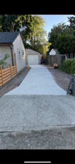

Switching gears a little bit- I wanna take advantage of the cooler weather we’ve got this week, so my gf and I pressure washed and crack filled the last 1/3 of the driveway. Today on lunch and after work, I began pressure washing the middle 1/3 of the driveway, then doing the Portland cement treatment like we did on the garage. Plan is to probably do 2+ coats across the entire driveway, rent a sander for a day, then spray a sealer. Hopefully that will smooth out the surface and make it look more presentable. Time will tell!IMG_2487.jpegIMG_2489.jpeg
T
Tim_with_a_T
Dec 30, 2013
220
Vancouver, WA
Lot of work, but that should make for a vastly superior surface for working on. It'll be worth it.
Man if it can make rolling a cherry picker across it even a little easier it will have been worth it lol
Thanks guys- exactly what I’m thinking- if I can roll a cherry picker across the driveway without dumping the engine, this will be a success. If I can skate in the driveway after all this, it will be a massive success.
Lunch break progress- got the last 1/3 of the driveway brushed in with Portland and the next large crack filled in with mortar.

Last night, my gf and I got the remaining cracks filled with mortar, as well as painted the remainder of the driveway with Portland cement. I had some left to use up, so I began the second coat up at the garage side last night. This morning, I completed the remainder of the second coat. It definitely took less cement on the 2nd coat, so I know it’s filling in all the low spots. Right now, about 3/4 of the 3rd 94lb bag is used up. I’m not sure if it will take 3 coats or more, but I’ll see what it’s like after the 3rd coat and make the call.

Welp, lonnnnnnngggg day today. I woke up and after looking at the driveway, decided to just go straight to sanding instead of doing another coat. My reasoning was I had about a half bag left, with a full unopened bag, and I knew the half bag wouldn’t do the whole driveway, while the unopened bag would only get maybe 1/4 used.
I made a giant mess in the sanding process, which took just as long to clean up as the sanding process…. I also think I may have killed/maimed the rented sander…. Sigh. I let the guy know, who said, well good thing there’s damage protection!
The driveway is definitely smoother! It’s not quite skateable, but definitely smoother rolling a cherry picker across. I guess you can skate down the driveway, like one push will take you to the street, but it’s a little lumpy, so doing tricks would be a bit annoying. Previously, one push would get you about 4 inches. Anyway, worth the effort I think. Either tonight after it cools down or tomorrow morning, I’ll spray a sealer and call it good.
Edit: just wanted to add, previously walking barefoot on the driveway felt like broken glass- now it feels smooth, but still textured. I don’t know how many coats it would take to totally fill up the voids, and at what point would it just chip and crack out etc. Overall a massive improvement- I’m happy with the results but pretty wiped out. I’ve been on my hands and knees the last 4 days and my body is ready to take a break lol.

That driveway looks DRAMATICALLY better. Maybe I missed it but why doesn't it extend to the curb?
lol. Good question- I didn’t do that part because then I’d end up doing the sidewalk on both sides and it would never end lol. Additionally, the city has been pouring new sidewalks in patches here and there, so I’m optimistic they’ll eventually just pour the whole block… I was also trying to keep my mess contained and out of the street (storm drains), although today was an absolute massacre. I ended up scraping mud off my neighbor’s sidewalk and driveway curb for a good half hour and it doesn’t look like I even tried to clean it up…
