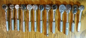

They used to make these things called "knurled handles" - you might want to check it out:
Knurled handles are great, they are on several of my smaller ratchets, but I don't have any knurled handles on my larger 1/2"+ drive ratchets. Also, I've spent too much over the years acquiring nicer large ratchets that perform their function according to my expectations, and I would prefer a $5 upgrade as opposed to replacing them. Its not as bad when I'm bare handed, but if I have latex gloves on, they get slippery as snot.
