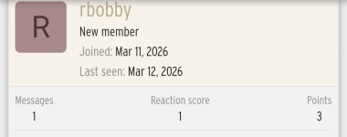

The guy asked the question in his one and only post 2 months ago and hasn't been seen since the day after.

Op looks like a troll or potential spammer.
Joined, posted thread and hasn't been back in 3 months:
