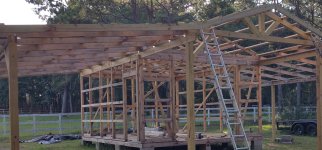

Looking at adding a lean-to to a new stick-built garage build I am still planning on Northeastern Pennsylvania. The garage will be 28x32 (with gables on 28' side) with 10 foot tall walls and 9/12 trusses for additional attic storage. I am looking at building on a monolithic slab. I am looking at also having a lean to built on the 32' side (either the entire length or half of it depending on additional costs). The lean to would be either 6 or 8 feet wide.
I'm not quite sure how best to attach the lean to to the structure. It looks like there are two options, either attach to a ledger board in the garage wall with the rafters running underneath the truss overhang, or I'm wondering if there's a way to attach over the top of the top wall-plate and have the main roof continue at a lower pitch. This way the end of the rafter is supported by the garage wall and not the truss and the facia is continuous, but I realize theres probably something obvious I'm not considering with this.
I've attached a sample picture showing the first option, but I'm just not crazy about the two separate roof sections and want to know other possible options. I'd prefer the lean to doesnt look like an after-thought and blends with the existing building.

Nothing wrong with your leanto attachment! It saves you dealing with an additional eave to build and trim out. It will also shed snow better than it dropping onto the lower roof. I'd suggest a metal roof.

Thanks for the feedback. Just to be clear, are you saying what I described with having the rafters bearing on the wall plate is feasible, as opposed to the example picture I attached that uses a ledger board and separate roof?
I've seen some suggestions about having the main structure's roof trusses be a raised heel truss to allow clearance for a rafter to be placed along side of it over the wall plate.

Anyway I built mine like this. Lean to rafters sit on the top plate right next to the trusses.

Yes, you'll have to cut a correct birds mouth at the bearing point on the wall plate.
I'm confused if you're using rafters or "attic trusses" for the main roof?
Do you envision the same pitch for both the main and leanto roof?

My 16’x50’ lean to was constructed after the fact. There’s a mono slope roofline, presumably to help snow shedding. No contractors I talked to would willingly recommend an interrupted pitch roof for that reason, although I know they’re popular in mild climates. A friend added a metal roof to replace the shingles on his old mining era house. There was a couple foot drop between the main roof and the “shed roof” over the kitchen.
You guessed it… ice fell off the upper roof and punctured the shed roof over the kitchen,
My original structure was stick built, using trusses. The lean to uses posts on the outside wall, with bird mouth rafters sitting on the existing top plate. The rafters follow the original pitch, and I presume simple geometry defined actual room width.
0ne contractor, if I understood correctly, stated that the new at the time building inspector was putting up resistance at using different construction techniques in the same building. Ie monolithic slab for the main building and buried posts on a concrete pill for an attached lean to.

A lean-to that is only 6 or 8 feet wide is not for parking. What do you plan to use it for? At only 6’, you may be able to just order trusses that cantilever that far without posts. Eight feet is possible but pushing it, depending upon hurricanes or snow load. Four foot is sufficient for firewood or a canoe or maybe even a fourwheeler. Ten foot is the minimum for cars and trucks, twelve is better for trailers.
My rafters are birdsmouthed at each end and sit on top of the walls and sistered to the roof trusses:
I cut in an additional birdsmouth for a ledger board at the top of the wall but it seems it has been fine without the extra overkill.
I continued the 4/12 shop roof pitch on to the lean-to primarily for snow shedding, but avoiding leaks at a flashed pitch change and avoiding the extra cost of additional fascia is not without merit.
