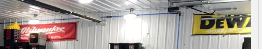

Our shop will have 100 Fc of 4000K lighting via 8 x 150W UFOs from Hyperlite . I recently picked up some 5000K contractor lights (also from Hyperlite); you can see them both here in the pic below. I'm planning on task lighting at the lathe & mill since that work requires a lot of light.

I am also going to be hitting the ~100fc mark with my lighting. 227fc is a lot! 200w+ at 12ft is probably going to be like spot lights. I just got my first light up (temporarily). Pic is set on 150w, at ~18' high. There will be 14 of of these fixtures installed in my 44'w x 56'l shop in a 4x4 layout.

These are not dimmable but I broke the lighting into four switches. If I leave the far row on and turn the rest off I get “bar lighting”.
I think the diffusers make a big difference. Spreads the light out and it doesn’t blind you if you look at them.
I suspect the diffusers are a good choice. Especially if the lights are in line of sight as opposed to very very high.

I have 10 ufos at 200w 5000k. They are up at about 18 to 23ft. I still need to add in 2 more closer yo that far wall and 4 more where im standing at to take the Pic.
It's a 40x60 and those lights are in a 40x40 area.

I went with 14 of these.
I could have gotten by with 13 but I figured that was bad luck.
I shortened the cord and hung them directly from the electrical box (and no they don't get too hot)

I usually love to hate on off brand lighting, but those diffusers look awesome.
Those completely transform a UFO light

Not the appearance of the fixture itself silly.
Look at the light on the floor, walls and ceiling. WAY better than most with ufo's

The diffusers are actually supposed to be there.
If you think back to the old domed highbays, you always had diffusers, either spun aluminum or prismatic acrylic. The aluminum was typically used on higher ceilings to help focus the beam onto the target. The acrylic was used for the opposite reason, to spread the light out as much as possible. Imagine a 400w Metal Halide highbay with just a bare bulb and no diffuser. Yikes.
When LED UFO's came out, they were fairly directional at about 120 degree beams. Almost a cross between the aluminum and the acrylic diffusers, but not as good as either. Most manufacturers still offer both diffusers and we highly recommend them. UFO's are intensely glarey and the diffusers help eliminate that, and the acrylics do a great job of spreading the beam out. You have to make sure to include the diffusers in any lighting calculations that you do.
The cover for the diffusers, as previously pictured, was traditionally there just to catch the glass when a lamp would explode. Falling shards of hot glass is not cool. Used on a new UFO, however, they're only decorative and probably increase the temperature of the diodes which isn't great for them. It looks good, though.
