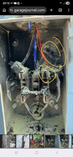

FIRE! What was supposed to protect me from this?
dave*99
May 5, 2009
4,255
Coastal NJ
Sure hope the coax wasn't in the meter can where that chunk came out of
Of course not. But fault current often finds its way onto the coax. Particularly when there is an open neutral. And the neutral/ground system was certainly part of the fault current path.
You can see what may be a ground rod connection to the cable system in this photo.

Piece of melted wire and insulation. Can’t tell where it fell from.
Line side wire. It fell off and across the bottom jaws when meter was removed.
Thats my guess.
And as I previously mentioned thay line wire and line side jaw started the whole mess.
Thats my guess.
It seems to fit there, but I didn’t want to speculate.
Ive seen thousands of these. Literally.
Of course looking at pics is not like seeing it in person though.
That piece of wire (red) is the line side wire .
It's about the only thing of that size thats gone .
The blue neutral is mostlu.still there and appears burnt off below the entrance ****** into the can.
The yellow is where the initial hot spot was at on that top right jaw. It is spread , no longer had any spring tension and disclolored. It got hot and failed. The arcing transferred to the back of the can and burned holes.
All the while the line wire burned up and took the lineside neutral with it.
Thars why the ground wire inside is burned up. It took most of the fault current.
