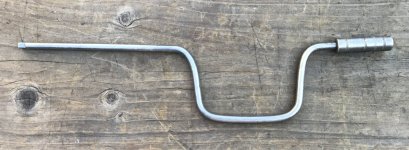

With regards to lug nuts, the 1/2 flex head speeder performs both functions. Speed on the nut and then swivel to tighten as you would with a breaker bar. Same for removal.
i.e. Snap-on SN4B

I use my Snap-on SN4B frequently when removing single wheels for repairs, and don't want to get the impact wrenches. I can loosen the lug nuts with the breaker bar feature, then straighten the tool to run the lug nuts off in speeder mode. I find it quick and handy. When installing the wheel, I can tighten the lug nuts in preparation for the final torquing with a torque wrench.

I have a couple of snap-on 1/4 speed handles and use them a lot. Nice for starting small screws where you have to use your other hand for holding parts in alignment and be certain the screw starts properly. WIth a ratchet, T-handle, or spinner handle it's hard to get more than about a half turn before you need to reposition your grip. A little practice with a speed handle and you can just keep turning one-handed.

I use mine for changing batteries. Everything holding a Honda battery can use a speed handle with a 10mm deep well. A battery swap can be done in a couple of minutes.
