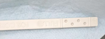

I have a new zero turn mower that uses the FR691V engine. Exactly 1.0 hours on the clock. I checked when I got it brand new and it was at the full line. Now after 1.0 hour it is at about half way in-between Full and Low marks. Seems a bit excessive to me? What should I do, any recommendations?

Two thoughts:
1. Personally. I like the oil close to the "High" mark but as long as the oil level is between the high and low marks you'll be fine.
2. I don't know how many ounces of oil is represented by the distance between the low and high marks, but I'd think burning through half that amount in one hour would produce a noticeable amount of oil smoke.

That's both sides. Blue arrow is where I believe the oil level is. I'll leave the dipstick out for a bit with painters tape covering the hole. To see if I can get a more accurate reading and be more confident in my reading, that it is left than half full.

What is your opinion from what I can see on the dipstick, without leaving it out for a bit? To me it looks like 1/4 of the way above Low. I do not notice much smoke during regular use, but I notice a lot of smoke at startup from a cold start. During a cold start, the engine seems a bit out to ordinary to starting a small engine. I don't have much small engine useage or work, but have done a lot for car engines.

After sitting for 24 hours with dipstick out:
After doing a single dip:
I know meaningless without knowing how much to get to full. I will do an oil change before next usage, measure how much comes out exactly, and measure how much I put back in.

If that is a Kawasaki engine with a screw in dipstick it usually says to check the oil without threading the cap on.

As JeepYJ said, oil level is checked without threading in. FWIW, I have the Kawasaki V-twin on my zero turn, now going on year 8. Typically around 70 hrs per year, change oil and filter at end of mowing season. I use 5W-40 synthetic diesel oil. Not burning any oil. I also used a longer filter Fram Ph3600 or equivalent number.
I would just top off with any 5W-30 or 10W-30 oil. The burning should reduce as the rings seat and engine breaks in. Don't overthink it.

JeepYJ is correct to say to check it without threading the dipstick in, is it possible (everyone in human) that the dealer checked it with it screwed all the way in? We have a fleet of 10 mowers with Kawasaki engines on them and this is how I service them. First oil change at about 50 hours and then every 125 hours give or take after that. I use Napa filters and regular 10W30 (not synthetic) and have not seen any oil related issues (knock on wood) We typically run 400 to 500 hours a year on the mowers and I consistently get over 3000 hours on the motor without much issue (a couple of head gaskets and one cracked head in 8 years that I've been responsible for them) which I feel is a fair amount of run time in a commercial environment run by employees who may or may not care about the equipment as they should. I've found that the Kawasaki engines seem to hold up the best in our situation compared to the other engine manufacturers offered by our brand of mower (Scag).
