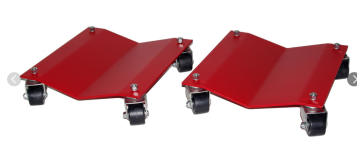

DaChev
Dec 10, 2015
64
Go jacks would not fit on my Corvette, so I ended up with a set of these. I get the car close, put it on these and I can move the car to get it in the perfect spot for the lift. Still a pain, but I have a set of 2x10 ramps for the same purpose and if the car is 1" too far to the right the day *****.
