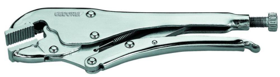

Slight tangent - parallel jaw locking pliers.
Gedore 137 P
Gedore 137 PA with smooth jaw (discontinued)
Stahlwille 6562 (similar but not the same, I believe).

But actually we are still on the broader theme of parallel jaw pliers with some form of clamping or locking mechanism.
