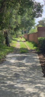

I have a walking trail that crosses my driveway. I just found out that they want $6000 to deliver cable to the property.
I'm assuming its becuase of the trail. This used to be a railroad, but now its just a recreational walk way.
I was thinking I could run a pipe under it, I can dig down on either side and then maybe hook up a water line and drill across a few feet down. I am not sure if it would have a thick road base as you can't actually drive on it.
Anyone think I can keep a PVC pipe straight enough to make it all the way under? What size pipe would you go with?

Having been a railroad, wouldn't it be likely to have a significant base under it?
That looks like a very long distance to DIY with a pressure washer. I suspect you'll end up with a big hole that could run the risk of undermining the walkway.
Did you ask how much cheaper the bill will be if you put the conduit in?

I would first find out if that's why it cost that much. Utilities directional bore all the time , especially gas crews.
At least around here they do because the gas main only runs down one side of the road. Same with water.
But yes it's pretty easy depending on the size conduit you want to install.
I had to go under a double driveway for a gas line at the old house.
3/4 PVC with a cap on the end with some 2 or3 small holes so the water would jet through. The free end had a PVC female hose adapter.
Dug down about 18" and back about 2 or 3 ft to get the pipe to lay as flat as possible.
If I had to do it again I would adapt a pressure washer line and fittings to the PVC it would jet through with ease.

A few rocks worth of deflection and you'll be anywhere but where you wanted. You could easily become dead-headed against large rocks/boulders and then you're stopped dead.
I too, wouldn't consider that railroad bed just some random soil.

i have done this a few times.
using water pressure eroded too much soil & caused the driveway to crack over it eventually.
the next time i did it i pushed a steel pile under with the bucket of my mini excavator. worked perfectly. i ran power & water line through it.

How wide is the trail that you need to go under? I've done it a few times but never that wide. We used to just pound a 3/4" emt pipe under a sidewalk and then tape the wire to it and pull it back to get electricity out to post lamps. But that was only 3-4' sidewalks. I dug out my mom's foundation a long time ago to install drain tile and waterproof her basement walls. The driveway was 3' from the house on one side and there was a stoop to the door that I left in place and dug on both sides down to the footer. To get the drain tile under the stoop I used a piece of 4" PVC and my pressure washer inside the pipe to remove the dirt and push the pipe through. But again it was only 4' wide I had to go through.
Think if I was going to try to go under that walkway I would use a 2" or so pvc pipe. Take a 5' or so long piece and use a cap on the end so you don't damage the pipe and pound it in as far as it will go. Take the cap off and then use a sewer jet hose with a pressure washer, https://www.amazon.com/Pressure-Cle...aterproof/dp/B0FL7MMCFF/?tag=atomicindus08-20. Stick that in your pipe and flush out the dirt. Then just keep repeating and adding pipe sections until you get through. I would dig a hole on both sides down pretty far to try and get below all the base that is there for the old tracks. The dirt will still be compacted from the heavy trains going over it but should be easier then the gravel base they most likely used.
