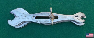

Ronson Specialty Co., Newark, New Jersey - R4 4 pc. "Nine-in-One" Wrench Set
1/4" x 1/2" Ronson "Nine in One" Wrench (with 1/4" square hole for Prestolite gas lamps)
5/16" x 19/32" Ronson "Nine in One" Wrench
3/8" x 11/16" Ronson "Nine in One" Wrench
7/16" x 25/32" Ronson "Nine in One" Wrench
Screw and Wing Nut
* Patent 942993 Dec 14 1909 Louis Vincent Aronson
* This is an early production set, manufactured prior to the largest piece being supplied with an "alligator" wrench opening.
The only documents I've been able to find for this R4 set date from 1909-1911, and then from 1919-1923 - so there's something of a gray area there. Later sets have an "alligator" opening and screwdriver blade instead of the 25/32" opening.

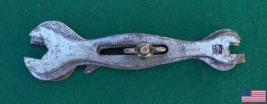

Ronson Specialty Co., Newark, New Jersey - R4 4-pc. "Nine-in-One" Wrench Set
7/16" x Alligator Wrench with Screwdriver Blade
Screw and Wing Nut
* the gullets of the 5/16" x 19/32" openings were modified by a previous owner. (to fit Delco magneto?)
:unsure:

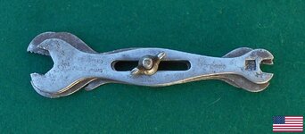

Ronson Specialty Co., Newark, New Jersey - R4 4 pc "Nine-in-One" Wrench Set
Screw and Wing Nut
