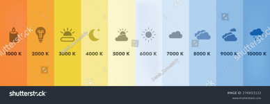

Like everything preferences vary greatly. Bright to one person is not enough to another. 6500K would be very uncomfortable for me to work in and I don't even like 5000k as it feels very harsh. My garage is 4000k
Count on anything you buy today not being available when a fixture fails, so an extra or two may be prudent.
At 12' wide, I'd probably do two rows about 3' off each wall and then more where task lighting is needed. So that's 8 fixtures plus task.

The sun is 5,800k, and 4,000 is too yellow and unnatural. 6,500 has quite a bit of blue, which is what I like as a autobody & paint man. Retired. We've been saltwater reef hobbyists since 1993 and we prefer 6,500k for corals and fish. Deeper water corals go from 10,000k to 25,000k, which are very blue. Anyway, I could talk reefing all day, so I'll stop. lol 1993

It's your shop, do whatever you want. I'm saying it wouldn't work for me.
4000k doesn't look yellow to me and I'm not diving in my garage 😂

Much better, no point light sources, only 5000k.
