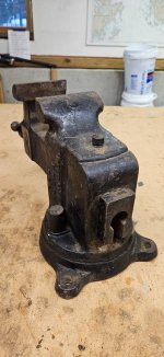

The PO describes the condition of this 404 1/2 as “fair”. Seems a lot better than that to me. To my eye, looks like original japanning, crisp tail edges and fairly smooth jaw faces. Besides the missing lock handle, and a random dings, anyone see something I don’t? How would you describe the condition?
Even though the paint is old, it’s not original. No vise manufacturers I’ve ever seen (understandably so) painted the slides of their vises, and that one shows clear traces on the slide. That said, all things considered, I’d probably still put the condition at higher than “fair”.

I’ve seen enough old vises that appear to have been assembled, and then painted, including the slide, that I think painting the slides was occasionally done.
I don’t know how common it might gave been, and mostly it is less expensive vises where I’ve seen the issue.
Whether Reed would have done it, I don’t know, but it would not surprise me if dome Industrial manufacturers did it, just to get vises out the door at slightly lower cost.
The paint would also have helped protect exposed areas of the slide from rust.

Reeds have a tight enough slide fit that it could cause binding from bunched up scraped paint, so unlikely.
the only painted slides from a factory I've seen are cheap homeowner's models and cheap imports.

Turns out, the OP’s “fair” description of the 404 1/2 was an over estimate. It is all there, and original, but there at least one problem I identified by taking out the slide. I offered $30, even though he wanted to give it to me. IMG_4347.jpeg
The screw is in inaccessible right now, so not sure how bent it is. The retaining sleeve bolt lacks a head, or slot for screw driver. Not the first time I’ve seen this.
